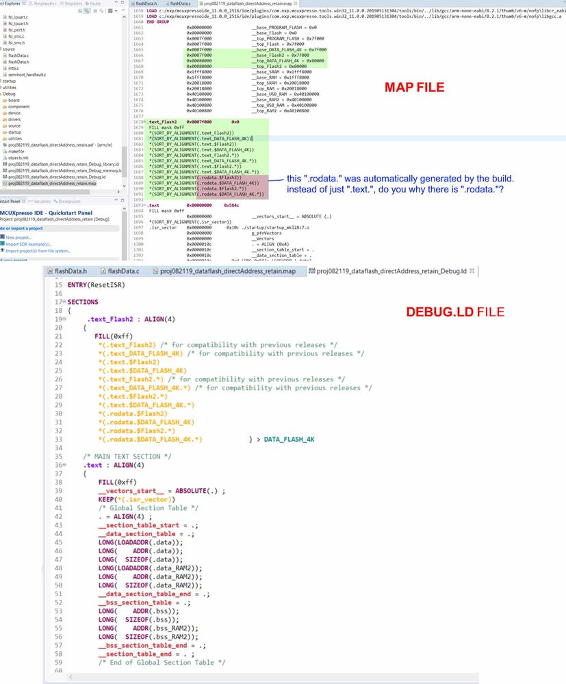

I hope Erich Styger will notice this post and help me out but all other experts in linkers and section attributes for data in flash memory are very welcome.  Thanks.
This image shows the collage of the different screenshots of my situation.
* I split MKL28Z's 512KB flash memory into 508KB (code) + 4KB (read/write data non-volatile area).
* I got an example project code from NXP support, modified pflash imported SDK project, that defines a string, tt, in the .text / code area by using a sectioning macro from <cr_section_macros.h>
* Both our builds result in the warning: setting incorrect section attribute for .text.$Flash2
* show different files automatically created:  linker description script, map, MCU settings memory map, snippet of code where tt is defined, build warning, manage linker script input section
QUESTIONS:  What can I do to make this warning disappear? where should I do it? in linker section file? in manage linker script?... what "Input section description" (in place of *(.dummySectionName1) should I state on description column, in the Managed Linker Script shown on bottom right corner of image?

2.  so builder automatically put up ".rodata" in my Flash2 section.   You know I only have 4KB assigned.  Do you know how big this ".rodata" area is? and is it correct to say it is on the uppermost area of the 4KB starting at 0x7F000?   I'm asking because the address mapping is not specified on any of the Debug & .map files.
6.  I think I see what you mean... you are right, the linker script is always automatically generated everytime I make changes to the code, it "re-arranges" the memory mapping again & again but only if there are changes.

This is screen shot of automatically generated map files - I don't have any .text macros on this.   I guess the MCUXpresso toolchain build/linker created the SECTIONS based on the "split" I did on the Flash 512KB memory.
Do you know why the builder put ".rodata." label within my 4KB Flash2?
And if I understood your statement above where application code will not go over or exceed 508KB, thanks to the split-up of Flash into 508KB and 4KB.   Both are still labeled as "text_" though.   Do you know if the builder will actually "complain" & post an error if the application code grew more than 508KB?   Is that what you are saying is the ADVANTAGE of splitting it up in the project's MCU property/settings?  But effective only within MCUXpresso IDE builds though, correct?    Thanks for your response to my questions.
Here are the map files:

1. I guess the MCUXpresso toolchain build/linker created the SECTIONS based on the "split" I did on the Flash 512KB memory.
Correct. MCUXpresso automatically creates all the sections for you, based on your memory configuration
2. Do you know why the builder put ".rodata." label within my 4KB Flash2?
MCUXpresso automatically creates tex and rodata sections for each flash regions defined in your memory configuration. If you do not have any rodata explicitly placed in that section, it will be empty.
3. And if I understood your statement above where application code will not go over or exceed 508KB, thanks to the split-up of Flash into 508KB and 4KB.   Both are still labeled as "text_" though.
Correct. Again unless you specifically place code into the 'split' 4k section, the tools will not place code into it. MCUXpresso will only (automatically) place code into the FIRST flash section.
4. Do you know if the builder will actually "complain" & post an error if the application code grew more than 508KB?
Yes it will. You will get a build error and will the axf file will not be generated.
5. Is that what you are saying is the ADVANTAGE of splitting it up in the project's MCU property/settings?
Correct.
6. But effective only within MCUXpresso IDE builds though, correct?
I'm not sure what you mean here. The linker script is created and so will happen anywhere that linker script is used (via the command line build, for example)

So, the warning is because you have defined a piece of data (that by definition is writable) into flash (which is not writable). There is a fundamental difference there that cannot be resolved and is correctly being reported by the linker.
As you know, you cannot write to random addresses in flash - you need to write pages, which need to be on page boundaries. The usual way to do this is to define a specific section in your code (not Text) and use the linker to place that into flash on a page boundary. You then use IAP functions to write to that location.
10,288件の閲覧回数
converse
Senior Contributor V
To answer the questions you originally posed:
Why is there .rodata?
- rodata is Read Only data. You can place text (code) or read-only data into your Flash2 section. I would suggest that you want to place your data into the rodata section (instead of text) using the appropriate cr_macros macro.
How to eliminate the warning?
- define your data as const. This informs the compiler that it is data and that it is constant (cannot be written to) and if you try to the compiler will issue an error. Yes, you are going to use IAP calls to write to this data, but that is not the same as just assigning it a value in C.
So, you need to define your data as:
__RODATA(Flash2) const char tt[6] = "abcde" ;
