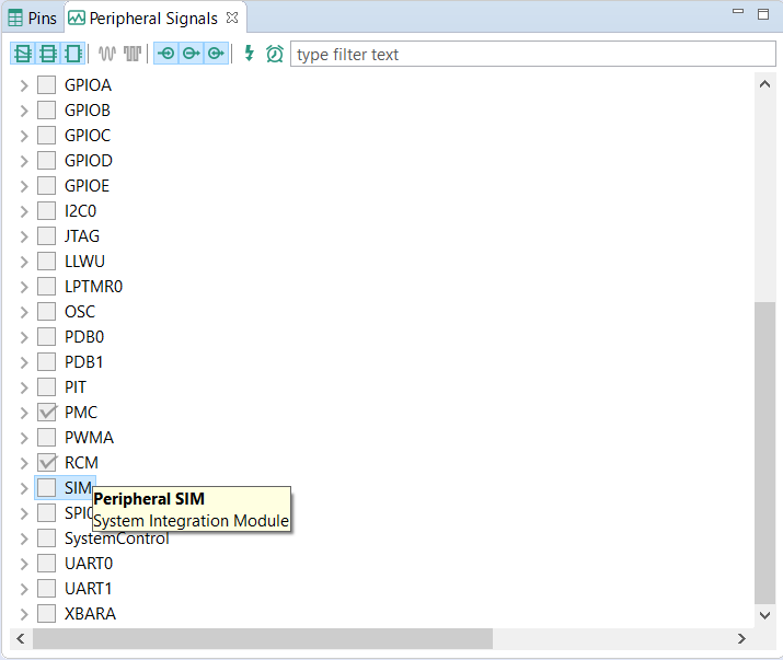

  1. In the Pins tool, select the Peripheral Signals view.
  2. From the list of peripheral signals, select SIM by clicking the box.

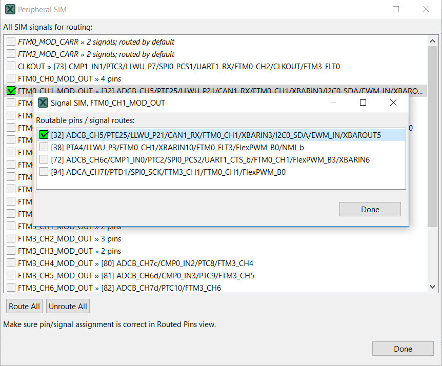

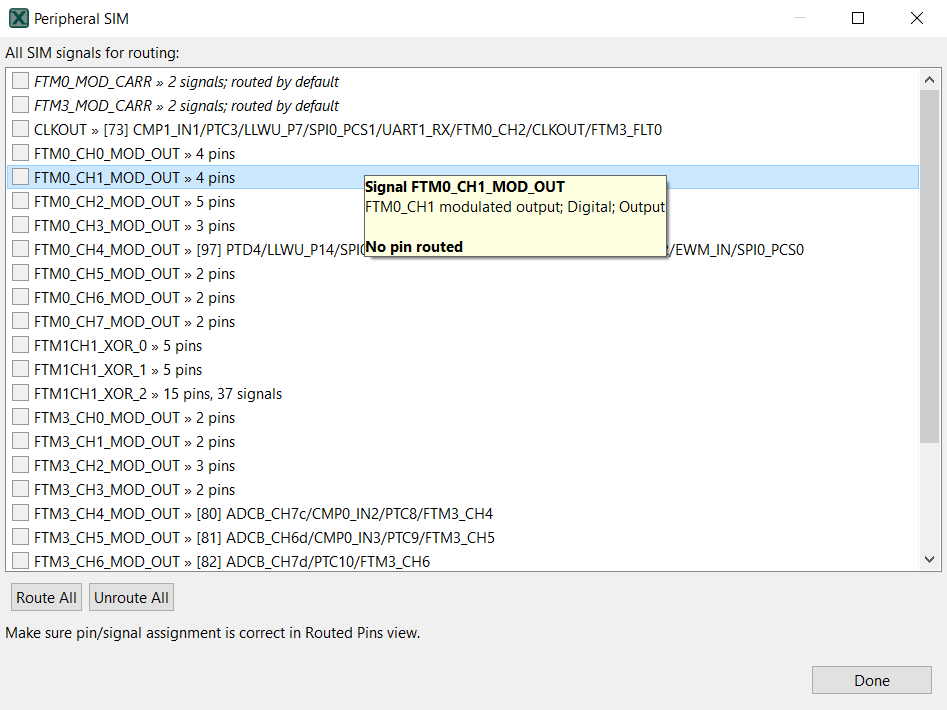

  3. In the Peripheral SIM window, choose the signal you want to route and the modulation signal. Signals available for modulations include the MOD string.SIM2.png
  4. In the Routable pins / signal routes, choose the pin / signal route.SIM#.png

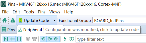

  5. Update code by clicking Update code and build with your IDE/toolchain.
