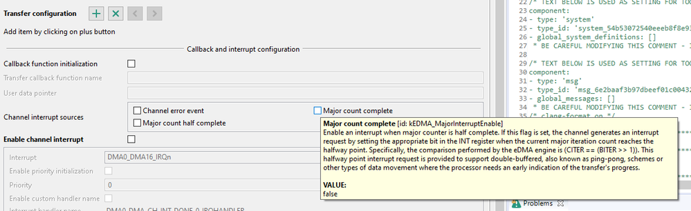

in the peripherals tool, DMA peripheral driver, the help text which gets shown when hovering with the mouse above "Major count complete" and "Major count half complete" for the Channel interrupt sources need to be reversed.
The picture below shows the text when hovering above Major count complete:
I am using MCUXpresso Config Tools v7.

Hi Stefan!
Thank you very much for your feedback. We fix this issue in following update release.
