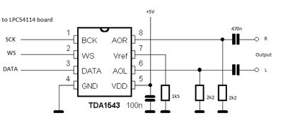

TDA1543 is a 16-bit DAC with stereo output. It is available in an 8-pin DIP package with 3 digital input signals. It can operate with a minimum of external parts.
The following diagram shows a simple testing circuit used for this project to get an analog audio line output. This schematic can be easily wired using a breadboard.
Figure 1. Schematic of an elementary audio output DAC using TDA1543

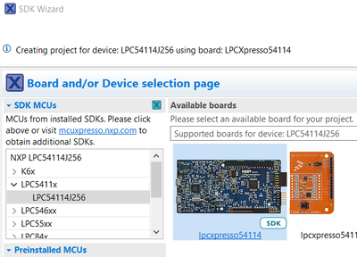

1. Create a project for the LPCXpresso54114 board. If you need, you can find detailed instructions in this video. (https://www.nxp.com/design/training/basic-application-development-using-mcuxpresso-ide-and-mcuxpress...)
Hint: Ensure you select the appropriate board:

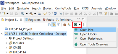

2. Open the Pins tool. You can use the tools' Menu button in the Project panel: Ana_39-1632315165563.png
        NOTE:
Ensure you have selected the appropriate project when multiple projects are in the workspace.

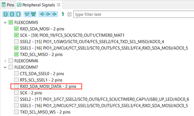

LPC 54114 MCU provides 8 instances of the Flexcomm communication peripheral that can be flexibly set for UART, SPI, I2C, but only Flexcomm6 and Flexcomm7 provide I2S interface. This tutorial uses Flexcomm7.
       NOTE:
I2S signals are marked red. FlexComm5 (and lower) do not offer I2S signals.

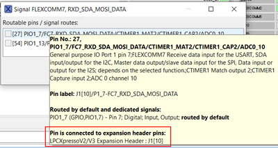

4. Check the RXD_SDA_MOSI_DATA pin. In the dialog for routing, select which pin you would like to route the signal to. This tutorial uses pin 27
Tip: Find which expansion header connector and pin the processor pin is connected to in the tooltip of each pin:
5. Repeat steps 3 and 4 for SCK and WS signals.
  • SCK – pin 26 (connected to J1[14])
  •  WS – pin 28 (connected to J1[12] and J9[6])

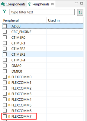

7. In the Peripherals tool, open the Peripherals view and check Flexcomm7Ana_43-1632315165675.png

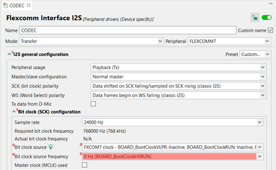

10. In the added configuration component, set up the following items:
  • The Custom name checkbox is checked,  the Name: ‘CODEC’
  • Mode: Transfer (Note: Transfer mode is easy to use and provides asynchronous operation)
  • Sample rate: 24000 Hz
  • Transfer Configuration / Transfer functions setting / Buffer size in bytes: 32

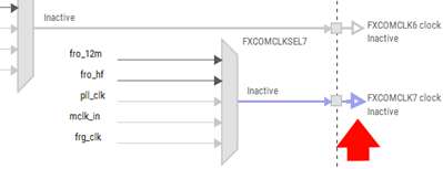

11. The Bit clock source frequency shows an error as the clocks of Flexcom7 are not enabled (inactive).
Right-click the “bulb” icon offering possible fixes for the problem. Select the error message FXCOM7 clock is inactive and select the action Show problem in BOARD_BootClockHSRUN, which is the name of the functional group in the Clocks tool.
It opens the Clocks tool and highlights the FXCOMCLK7 clock output related to                             Flexcomm7:

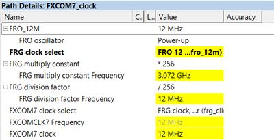

Configuring clocks
For correct communication, enable and configure clocks for the Flexcomm7 interface.
Steps

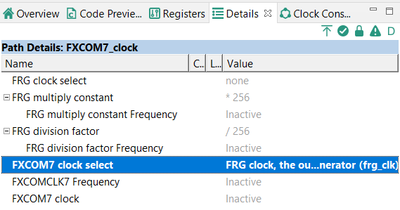

12. In the Path Details view (for FXCOM7 clock), set the FXCOM7 clock select to FRG clock, the output of
         NOTE:
FRG is a Fractional Rate Generator allowing to provide non-integer ratios for clock frequencies.
13. Set the FRG clock select to FRO 12.
The clock path and frequencies are automatically updated.

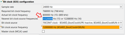

15. The bit clock source frequency is now 12000000 Hz and it shows a warning because it does not match a value suitable for producing the required bit clock.
The nearest bit clock source frequencies show potential suitable values. Copy the first one            (11520000) to the clipboard and switch back to the Clocks tool.
16. Paste the value into the FXCOM7 clock value column and add ‘Hz’ units; otherwise, it is treated as currently used MHz.
17. An error is reported. The Clocks tool cannot satisfy the requirement, so change the accuracy to a higher value.
Set it to 0.5 (which corresponds to 0.5 %):
Now the requirement is satisfied (producing 11.54 instead of 11.52 MHz):

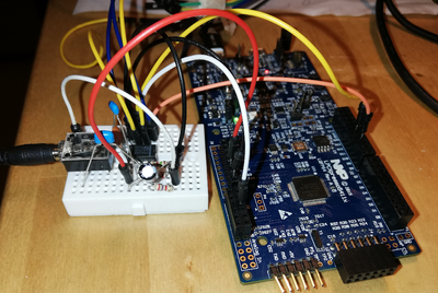

Testing on hardware
You can test the application on the LPC54114 evaluation board with a connected DAC chip.
Figure 2. DAC circuit wired with the evaluation board
The output checked using the sound-card input of a PC has the following result. It corresponds to the expectations:
