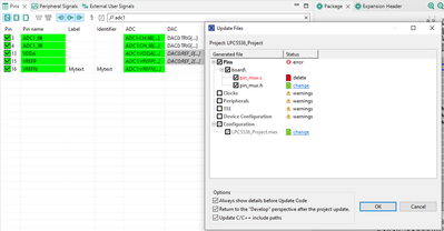

After updating to IDE v11.9.0 I changed some small settings in the peripheral init view.
After this there is an error in the Pins line in Update Files:
Problems in the code generation: [DATA] A failure during script execution: processors\LPC55S36...\pins_code_gen.js. TypeError: "Cannot get property "0" of null in <eval> at line number 3975
There isn't a pin_mux.c anymore and pin_mux.h lacks the terminating #endif and maybe more

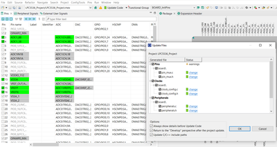

I found a simple way to reproduce the problem in a new project.
I created a new project using the wizard. All default settings. mcu LPC5536, SDK 2.14, IDE 11.9.
I enabled the pins ui. and set up five pins for ADC1 (which caused problems in the project i tried to update, as described in another answer.)
everything is good and pin_mux files are generated. I then changed the label and identifier of one of the pins and suddenly it can't generate the pin_mux files. It seems to be a problem to label the dedicated pins.

laugechristense
Hi @Pavel_Hernandez
Have you tried adding a label/identifier for the pins? If I add a label to one of the dedicated pins, the problem appears. I used the label "mytext" in the screenshot in my previous post.
I have attached the .mex file and the workspace with a project, that fails.
