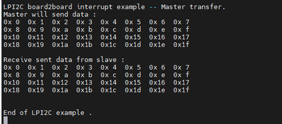

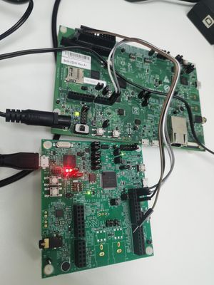

Hi @simmania ,
Thanks for your reply.
I did a validation as you do.
I create a new project, and set pin in Config Tool, I use the I2C pins just as you do.
and copy driver files from  evkmimxrt1010_lpi2c_interrupt_b2b_transfer_master to the new project, also I copy code from evkmimxrt1010_lpi2c_interrupt_b2b_transfer_master.c to the new project file MIMXRT1011_Project.c
I use MIMXRT1064-EVK board as I 2C slave.
I test that I2C can work normal.
Wish it helps you.

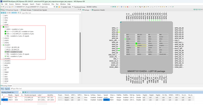

I copied some code from the example 'evkmimxrt1010_lpi2c_interrupt_b2b_transfer_master' into a new project. I did configure the Pins, Clock and Peripheral for the LPI2C1 port with the config tools, so I removed that code from the main function. But it does not work. While the example project did work.
So what am I doing wrong?
The clock for the LPI2C is configured for 10MHz, The pins GPIO_01 and GPIO_02 are assigned to the LPI2C1. And the peripheral is configured as shown in the attached picture.
The main code is listed below.
Note that when I run this program I do see activity on the I2C lines. It looks like the start condition is generated and then immediately both lines go high and stay high. The interrupt routine is called with status != kStatus_Success. The value is 905, but I can not found out what that means.

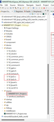

mayliu1
Hi @simmania ,
I'm sorry that you have  problem while using the NXP config tool.

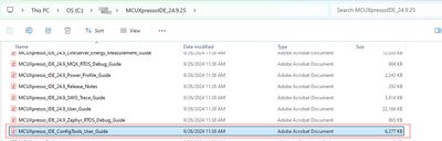

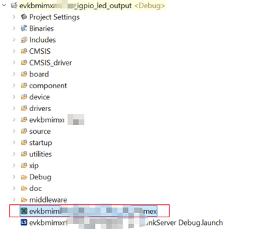

I want to know did you copy  evkmimxrt1010_lpi2c_interrupt_b2b_transfer_master.mex file   into your new project?
If you change I2C pin, Please double check I2C PIN configuration. Especially  Software Input On and Open drain need to be set enable.
If you want to know more about NXP Config Tool, maybe you refer "MCUXpresso_IDE_ConfigTools_User_Guide.pdf",  This file is in your MCUXPresso IDE installed path.

simmania
No, I did not copy the mex file, but I configured the I2C IO pins properly and checked for correct clock in the Clock Config tool.
