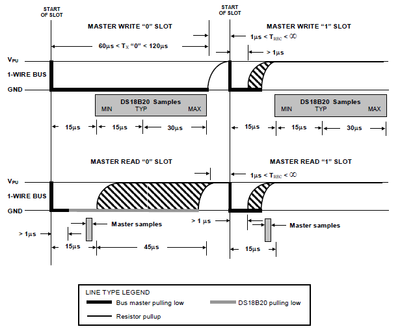

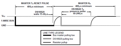

See the timing diagrams for communication with the DS18B20, needed for writing 1-Wire communication protocol.
Figure 3 Initialization Timing
Figure 4 Read/Write Time Slot Timing Diagram
The application only uses the following 1-wire protocol commands:
  • ‘CCh’ skip ROM command - only one slave on the bus supported
  • ’44h’ convert temperature
  • ‘BEh’ read DS18B20 registers (temperature)

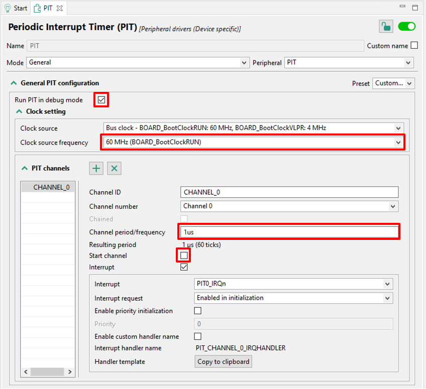

Steps to configure timer in the Peripherals tool:
  1. Go to the Peripherals tool and add/configure the PIT component. Resolve the new Error in Problems view by adding the SDK component to the project.antonintomanec_4-1630312697154.png
    Figure 5 PIT component in the Peripherals tool

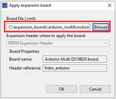

Steps to apply the expansion board and configure pin in Pins tool:
  1. Apply the expansion board (arduino_multifunction_ds18b20.xml) from menu Pins -> Apply Expansion Board menu
Figure 6 Apply expansion board dialog

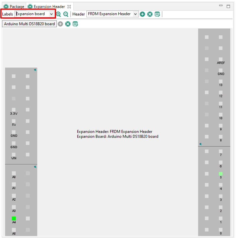

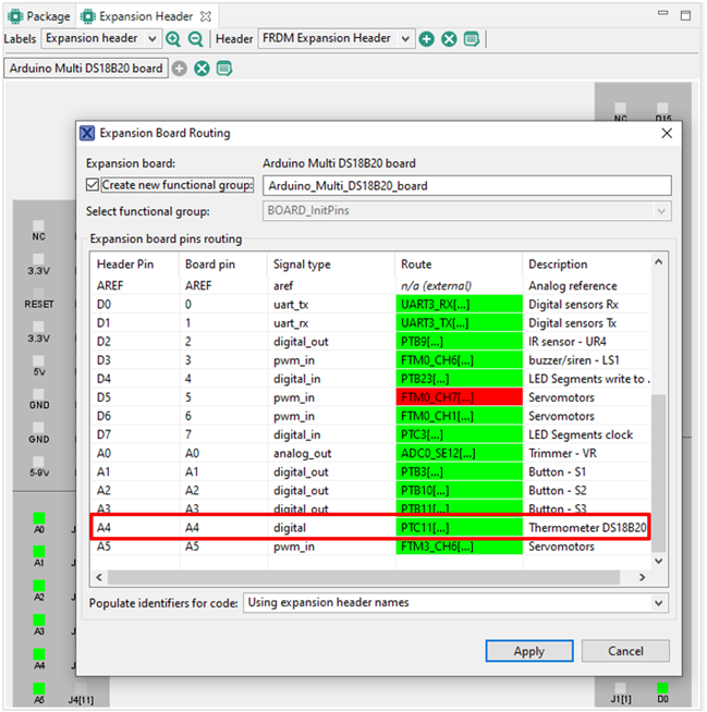

  1. The Expansion Board Routing dialog is automatically opened after step 1. It provides the possibility to route signals to processor pins that are connected to the expansion board. By default, all pins are routed automatically, see below. Keep only pin A4 routed which is needed for our thermometer application. Unroute the unneeded pins by clicking the Route column or later in the Routing Details view, then click Apply.
Figure 7 Expansion board routing dialog
  1. The action results in the following setting. When selecting Expansion board in the Labels combo, you see the labels as they are marked on the Arduino shield. antonintomanec_7-1630312697668.png
Figure 8 Expansion header view
  1. In the Routing Details view, set the electrical properties of the pin (Direction, Pull select, Pull enable).
Figure 9 Electrical properties in the Routing Details view

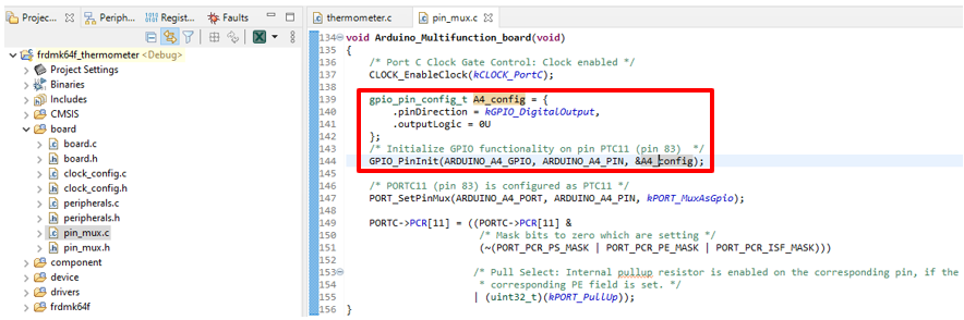

  2. Write methods GPIO_low() and GPIO_high() to set the ARDUINO_A4_PIN to logical 0 and 1. These methods are based on the code which is in the screenshot below.antonintomanec_9-1630312697858.png
    Figure 10 Generated code for ARDUINO_A4_PIN

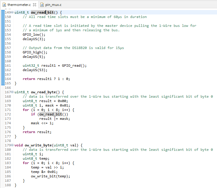

  3. Write methods for reading/writing bytes to the 1-wire bus.antonintomanec_10-1630312697916.png
Figure 11 Methods for reading/writing bytes
  1. Write methods to request the temperature conversion and read the temperature, see dsRequestConvertTemp() and dsReadTemp(). Finally, use the methods in main().

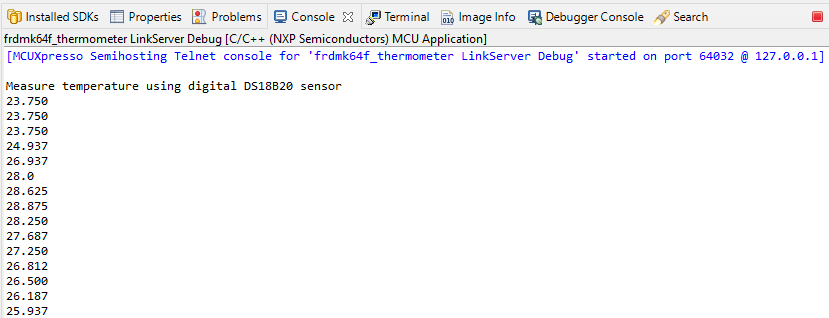

Build the project and start debugging.
Figure 12 Output from the application
