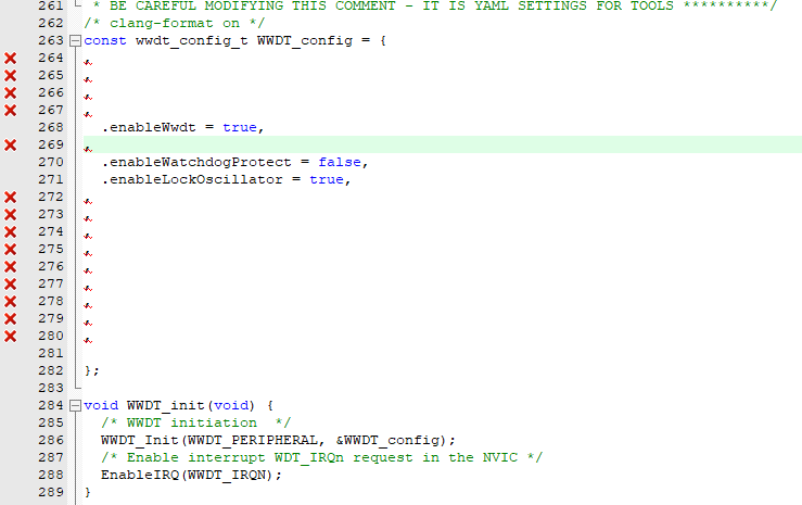

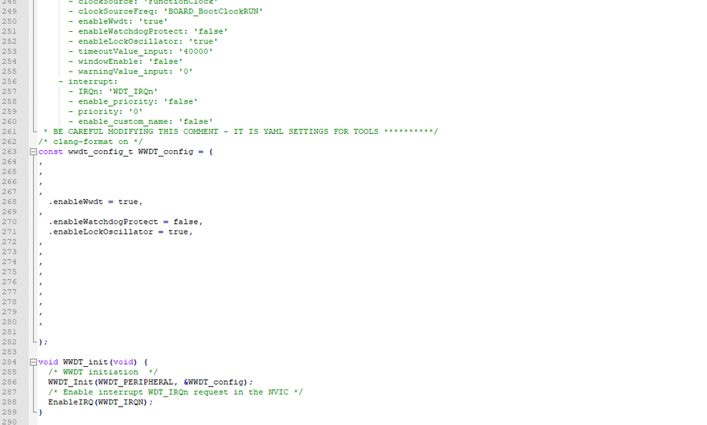

Using LPC802M001JDH20
As configuring the WDTT, even though everything (including clocksource and frequency) in Config Tools software is specified;
Config Tools provides the following inside peripherals.c:
const wwdt_config_t WWDT_config = {
.enableWwdt = true,
.enableWatchdogProtect = false,
.enableLockOscillator = true,
However, system fails inside fsl.wwdt.c -> WWDT_Init function @line 139 "assert(0U != config->clockFreq_Hz);"
Reason: Config Tool must add clock frequency inside WWDT_config struct:
.enableWwdt = true,
.clockFreq_Hz = XXXXXXX                <- should be added but not by the Config Tools
Unless you fix this section by adding clockFreq manually, code will fail @ assert(0U != config->clockFreq_Hz);

Lukas_Heczko
Hi Arda,
I think you are combining WWDT v2.0.0 MCUXpresso Peripherals tool component with WWDT v2.1.4 MCUXpresso SDK driver. Difference between the two versions is in the clockFreq_Hz item in the configuration structure which was not present in the older driver version. Please switch the component in Peripherals tool to the latest version (v2.1.2) which is compatible with driver 2.1.4. Please refer to similar question raised here: ConfigTools issue: Watchdog configuration for LPC54113
Regarding the issue with empty lines ended with commas, I'm not able to reproduce it. If you could attach the .MEX file generated by the MCUXpresso Config Tools I may try it on my side.

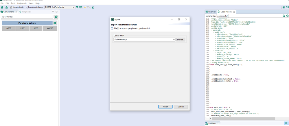

diego_charles
Hi Arda,
Thank you for your reply.
Unfortunately, I was not able to replicate the issue using the .mex file that you provided us. I have the same build of the tool on Windows 10.
If you export the code manually to another folder or project,  does the problems keep arising?

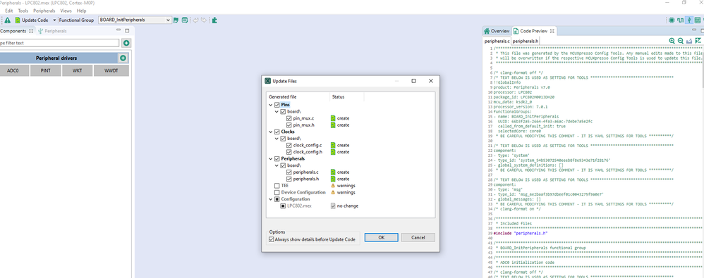

arda_otuz
I downloaded the attachment in an empty folder I have sent to you.
I unzipped and opened the .mex file and clicked update code:
The ouput of .c file:
It is not a big deal I guess, I fix the errors manually. Luckly LPC802 and my project is not complex.
Thank you for your support anyways. I will get going this way and hope some kind of update or windows update may fix it.

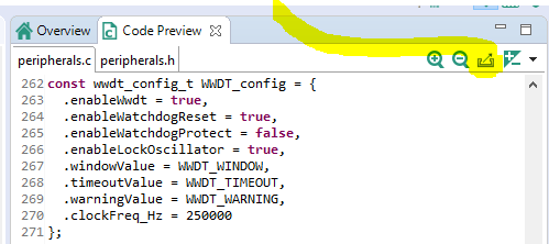

diego_charles
Hello, [email protected]
Thank you for showing the issue.
Could you let me know how did you configure the peripheral?
I haven't managed to replicate the issue. I created a project for the same MCU adding the WWDT driver. Then I went to Config tools->Peripherals and check the WWDT peripheral and let the Preset >>default and finally clicked on update code.
This the structure that config tools created for me in on peripherals.c
.enableWwdt = true,
.enableWatchdogReset = false,
.enableLockOscillator = false,
.windowValue = WWDT_WINDOW,
.timeoutValue = WWDT_TIMEOUT,
.warningValue = WWDT_WARNING,
.clockFreq_Hz = 250000
And my configuration for the peripheral.
Best regards, Diego.

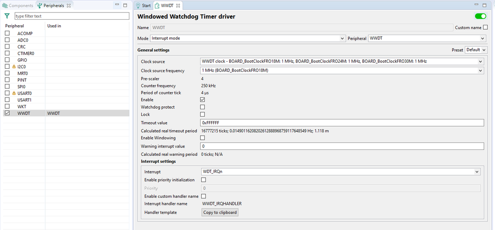

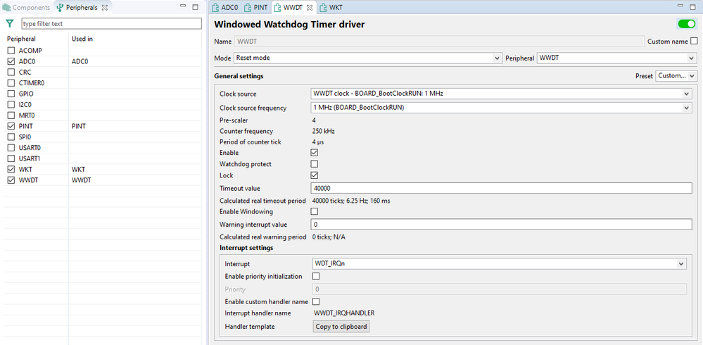

arda_otuz
Interesting, because the way you do it, it creates the code perfectly.
This is my configuration and the output:
No errors on the Keil side packages.
Code generated:
I even need to delete the commas in order to fix the errors.

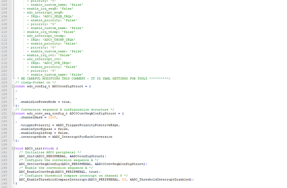

Also the ADC code is having the comma error issue.
