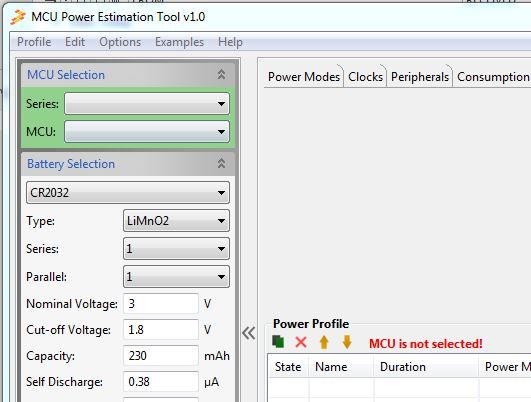

I just downloaded new Power Estimation Tool for Kinetis, but after installation, I cannot select any Series or MCU.
Did anyone already test this tool?

stank
Hi Iva,
I am using Windows 7, 64-bit.
Below the screenshot of the issue. Problem is simple, I cannot select an MCU - the list is empty.
Kind Regards,
Stan

ivadorazinova
Hi Stanislaw,
I tested on 3 computers, Win7, 64-bit with the same successful result.
Please, did you try uninstall and install again? Did you have any problems during the installation?
