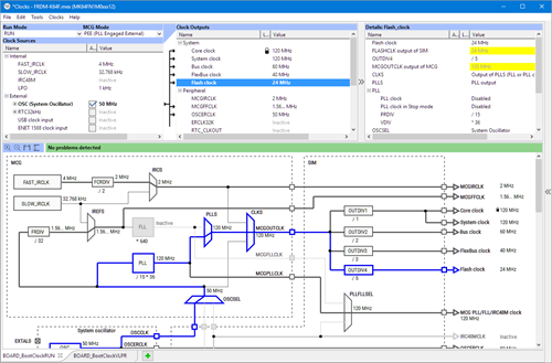

The set of the tools has a new member: the Clocks Tool:
  • Simple UI for clock parameter viewing and modification
  • Graphical view for easy navigation and visualization of settings and frequencies
  • Generate configuration code using KSDK v2
  • Inspect and modify clock configuration from clock input source up to the core/peripherals
  • Validate clock settings and calculate the resulting output clock frequencies
  • Determines suitable clock settings for given output requirements
  • Integrated with the Pins Tool

Clocks Tool
The new member of the suite of configuration tools is the Clocks Tool.  Use the Tools menu to select and switch between the tools:
The Clocks Tool provides graphical views for configuration and navigation in the clocks of the hardware:

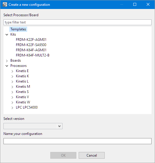

Templates, Kits, Boards and Processors
When creating a new configuration, it offers Templates, Kits, Boards and Processors.
Custom configurations can be stored as templates and then used for new configurations.

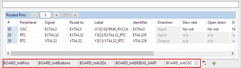

Board Specific Functions
With the provided board and kit configurations, there are now pre-configured initialization functions for major blocks on the board:

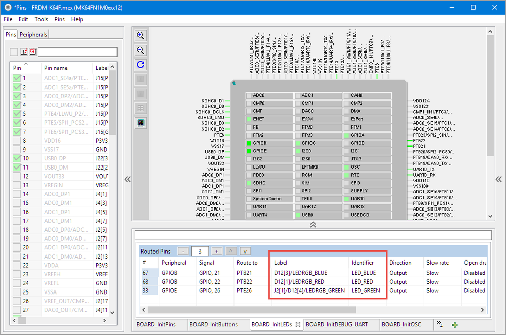

Labels and Identifiers
In the Pins Tool there are two new columns: Label and Identifier:
The Label is a user name/string to identify or describe the pin. The Identifier is a user C/C++ identifier which is added to the generated source code to be used by the application.

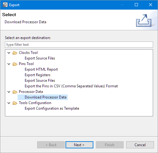

Export Data
To simplify downloading the device specific data for the desktop tool, the 'Export' function can be used to download and export the data. The data can be copied that way to another machine or all data for a set of devices can be loaded.

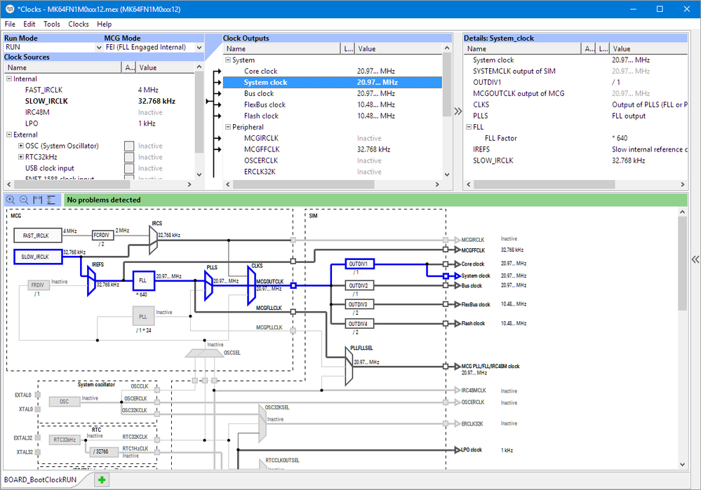

Using Clock Tool for MK26FN2M0VLQ18.  Can't set it above 120MHz.  The core is able to go to 180MHz.
Using PEE mode with 16MHz external crystal.
Any suggestions?
Brad
Please, set the HSRUN power mode (Run mode settings). The RUN power mode does not support 180MHz core clock frequency.
