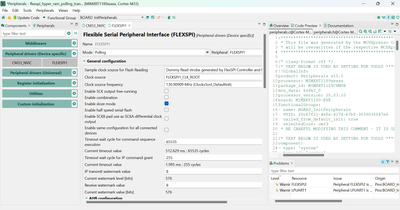

In the release note of MCUXpresso Config Tools, it has the following info for Memory Validation tool, but I can't find where to launch this tool from the Config Tools IDE. Also, in the user guide GSMCUXCTUG.pdf, it doesn't mention anything about this tool. That's confusing. Please confirm.

Take FLEXSPI as example, where is the button to open memory validation tool?

For FlexSPI please use the Register Initialization component, not the Peripheral component.

Thanks. I can find it now.

The Memory validation feature is available on top of Peripherals tool, for Register initialization component SEMC and FLEXSPI and for Peripheral device FCB.
Once one of above is opened you will find the button to open the Validation View on top right of the component window. The In Validation window you'll find all the supported tests and the test options.
The tests are executed using the configuration you do in the UI.
