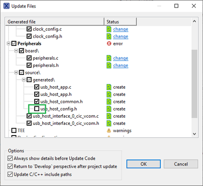

Hi I have a question related to peripheral configuration tool.
I have configured LPC55569 MCU to act as a USB host and enabled USB CDC auto-configuration for attached device.
The problem is that generated `usb_host_config.h` header file contains #define USB_HOST_CONFIG_CONFIGURATION_MAX_INTERFACE (5U) which I need to change to different value via Peripheral Config Tools tab.
The problem is that I cannot find that option in IDE. The only thing that I got is the shown in the screenshot provided.

Hi Pavel,
but it seems that the tools actually does change that line.
After I have set it manually to value 15, after generating the code, the value
is reverted back to value 5.
I have attached screenshot showing the change being made by the IDE tool.

Hello Antun,
The usb_host_config.h header file is generated as a parameterized template. The USB_HOST_CONFIG_CONFIGURATION_MAX_INTERFACE definition is generated as a fixed value now. It means that all changes are overwritten whenever you update the code. You must uncheck the code update of the header file to preserve your changes. See the following screenshot:
But this solution should be used when all USB host settings are selected. When you disable update of the header file any modification of the USB host configuration in the USB component UI will not be applied in your application code.
