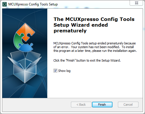

I try to install MCUXpresso_Config_Tools_v4_x64.exe on a Windows 7 computer.
I get this screen:
I tried it also as administrater with same result.
There is a item about this for Config tools V3, but not V4.
I added the log in the attachment.
Regards and Thanks

Hello Kurt,
Thank you for your interest into MCUXpresso Config Tools.
Also thank you for attaching the log file (we are trying to do an analysis now).
Could you please let us know version of your Windows OS and language mutation are you using?
Are you seeing this behavior first time?
Thank you.
Martin

martinformanek-
Hi Kurt,
I'm sorry for longer delay.
We found that issue is caused by PowerShell script which is doing some validation work within installer process.
Could you please go to command line and run
powershell‍
then two following commands and send me the results please?
get-host
$PSVersionTable‍‍

martinformanek-
Hello Kurt,
I'm sorry, but I'm back after longer time to your issue. There is an issue in rights for running of the PowerShell script on your machine with the highest probability.
Could you please try to run powershell and then these two commands and send me the result, please?
Get-ExecutionPolicy
Get-ExecutionPolicy -List‍‍‍
BR,
Martin

martinformanek-
Hello Kurt
please try out latest version of MCUX Tools. Reported issue should be fixed now
MCUXpresso Config Tools, Windows 64bit package
please let me know if it solved your issue or not.

kurtsterckx
Hello Martin,
I understand that it is a difficult problem!
This are the results:
Microsoft Windows
Copyright (c) 2009 Microsoft Corporation. Alle rechten voorbehouden.
C:\Users\beheerder>powershell
Windows PowerShell
Copyright (C) 2009 Microsoft Corporation. All rights reserved.
PS C:\Users\beheerder> Get-ExecutionPolicy
Restricted
PS C:\Users\beheerder> Get-ExecutionPolicy -List
Scope
ExecutionPolicy
