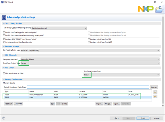

1.  Create a Secure project
Create a new project, select the security type (Secure), and set memory regions in New Project Wizard. You must do it as Secure and Non-Secure projects use different parts of memories. In addition, secure memories use aliases – the 28th bit is set to 1.  To download the firmware to the secure flash, select the Secure flash driver „LPC55xx_S.cfx“.

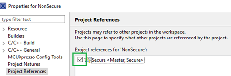

Reference the Secure project from the Non-Secure project. It makes importing memory regions into the TEE tool easier.  The current and the linked or linking projects are preselected in the import dialog.

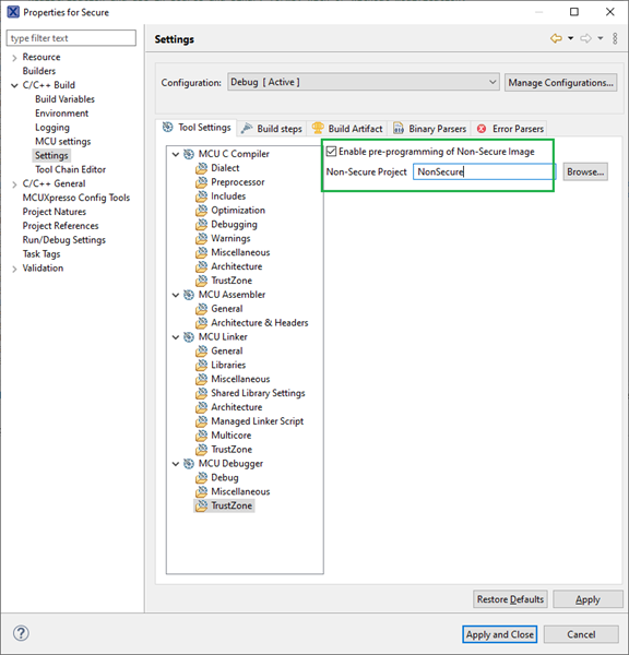

In the  Secure project set the Non-Secure project to be preprogrammed.  Both projects are automatically downloaded to the board prior to debugging the Secure project.

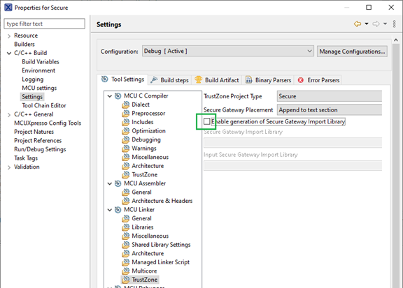

4. Disable generation of  a Secure gateway library
This feature is not used in this tutorial, therefore it must be turned off to compile the project. Change it in project properties (right-click the project and select Properties).

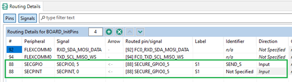

Open Pins tool. Route S1 pin to SECGPIO. For detecting button press, peripheral SPINT is used and it must be routed to the same pin. Flexcom, which is used as USART, is routed by default in a board configuration. Do not change anything there.

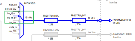

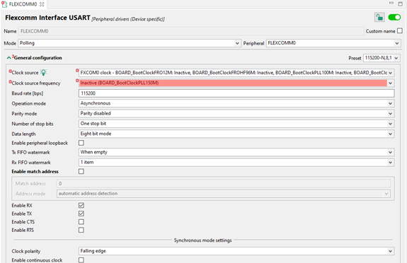

Flexcomm is used for USART communication. Open Peripherals tool. Add USART component in Peripherals tool. Use the default configuration.
Problems related to clocks must be resolved in the Clocks tool by enabling peripheral clock. Right-click the problem in Problems view and select Show problem. It opens the Clocks tool and highlights the problematic clock path.

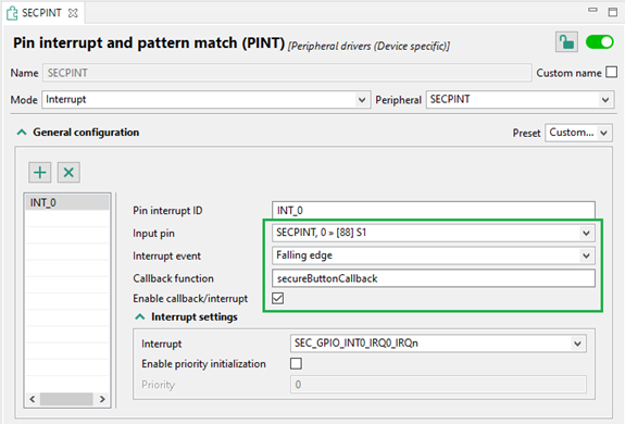

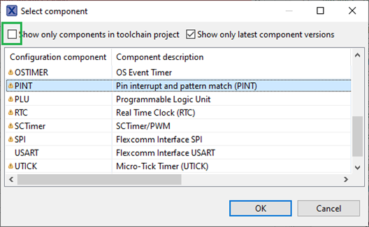

Add PINT component. Uncheck the checkbox „Show only components in toolchain project“  as the PINT driver is not in the project yet. Otherwise, it is not listed in the dialog.
Select SECPINT peripheral. Configure it to invoke a callback function upon falling edge is detected on S1. Add the  PINT driver to the project via quick-fix in the Problems view.

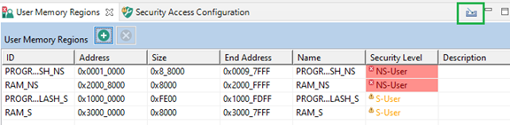

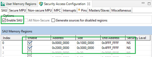

  • Import memory regions from both projects in the User Memory Regions tab. As nothing is configured for the security extension, there are errors and warnings in the Security Level column.

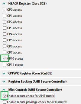

  • In Security Access Configuration, Miscellaneous tab enable Secure check for AHB matrix and Non-Secure access to floating point extension (CP10 access). FPU is turned on by default.

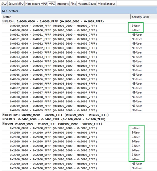

  • Enable SAU and set Non-Secure regions. Other memory is considered Secure.
  • Set MPC to allow only Secure transactions for Secure memory regions. It resolves errors and warnings in User Memory regions.

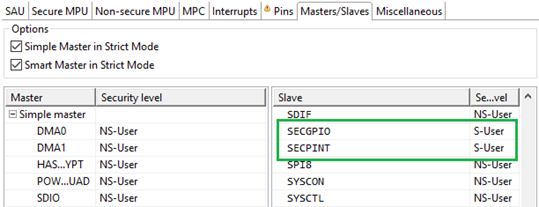

  • Set SECGPIO and SECPINT peripherals as Secure. Keep Flexcomm as Non-Secure for now for demonstration purposes.

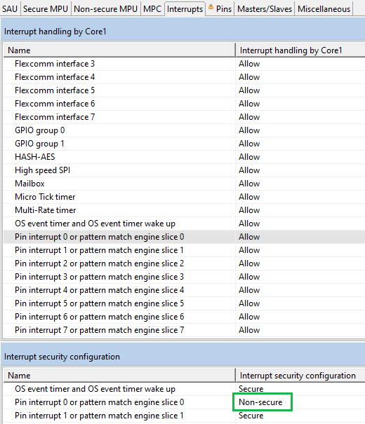

  • Set PINT interrupt security as Non-Secure. Sending data from the Non-Secure world is also triggered by button press so its interrupt security must be set accordingly.

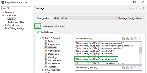

After updating the code, create a  TrustZone folder. By default, new folders are excluded from the build. Right-click the folder and uncheck Exclude resource from build in the folder properties. Add the path to the folder into Include paths in project settings.

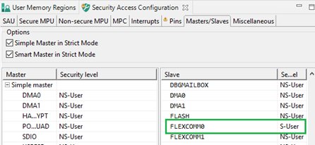

14. Securing USART
Open the TEE tool from the Secure project and set the Flexcomm slave as Secure. After this change, you can send data from the Secure world but an attempt to send data from the Non-Secure world results in bus fault.
