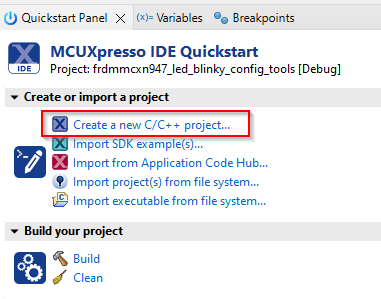

1. Launch MCUXpresso IDE and click Create a new C/C++ project…:

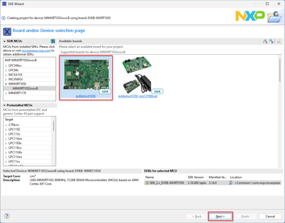

2. Select the EVKBIMXRT1050 board in the MIMXRT1050 processor folder, click  Next:

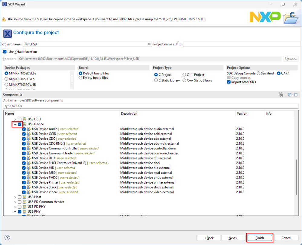

3. Specify the project name (for example, Test_USB). In the Middleware section, select USB > USB Device. Then click Finish:

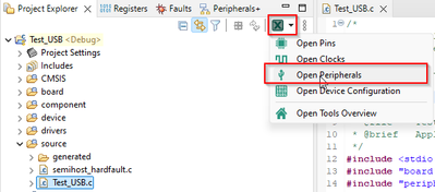

2024_10_09_000018.png2024_10_09_000018.png4. Unfold the drop-down menu (down arrow) of the Config tools icon (X) and launch the Peripherals tool:

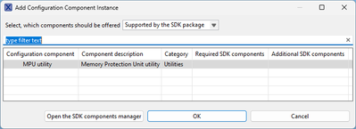

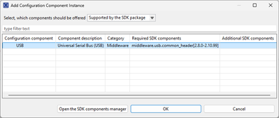

6. When the Add configuration component instance dialog appears, select the USB configuration component, click  OK:

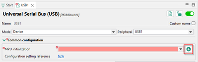

6. The USB configuration component instance is added. As it requires the component for MPU initialization, click the + icon to add it.
Confirm the selection of the MPU utility component in the dialog that appeared.

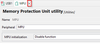

Keep the MPU component in the default setting and close its editor tab.

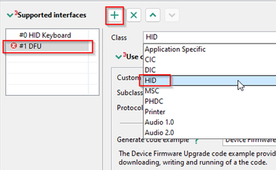

8. To add the mouse interface, click the + in the Supported interfaces section.

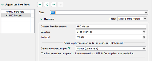

Select the newly added item and change the Class item to HID.
9. Check that the Use case Preset for the interface #1 is set to 'Mouse':

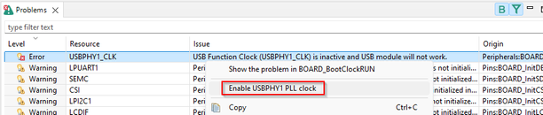

10. The Problems view shows an error as the clock function is inactive by default.
To enable it, right-click on the error and select “Enable USBPHY1 PLL clock”:
Note:  Optionally, it's possible to click the Show the problem… and adjust it in the Clocks tool.

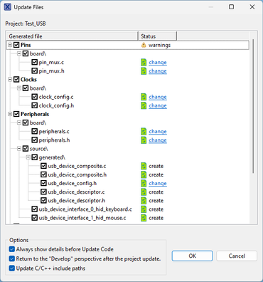

11. Click the Update Code button in the main toolbar, a pop-up appears:
In the pop-up, confirm the code update by clicking the OK button:

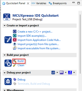

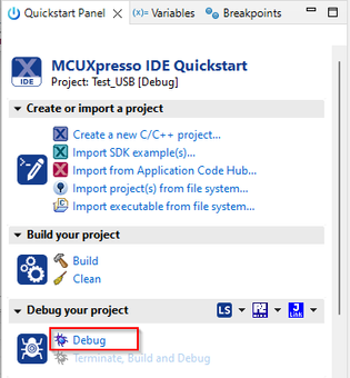

Build the application using the Build Command in the Quickstart Panel.

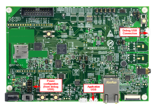

13. Now connect the board to the computer via the USB debug connection.
Note: The EVKB-IMXRT1050 board provides multiple USB connectors. For flashing the application, it is it’s necessary to use the debug connection.  Also ensure that the board power is configured properly. There are several other configuration jumpers on the board. So in case the application cannot be flashed or debugged,  follow the user guide of the board.

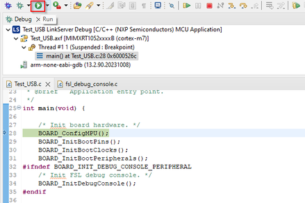

14. To launch the application in the debugger, click the Debug text located in the bottom-left corner of the IDE.
This launches the debugging and the connected board should be detected. Confirm the selection of the debug probe.
Once the connection is successful, launch the application by clicking the Run button.
