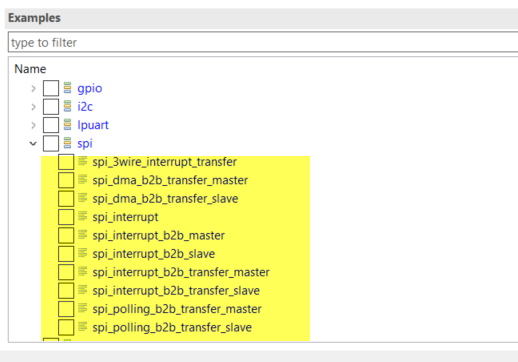

I will report it to development team. And now , I recommend you refer to the SPI demo under KL27 board,
Hope it helps,
