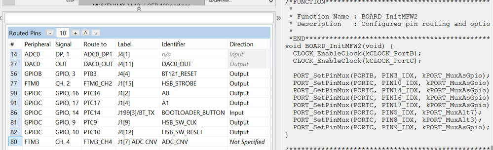

I specified a number of GPIO with Direction=Output.
The generated code does not set PDDR and leaves the pins in input mode.
What's going on? Should we not use this tool?

Pins tools does generate code for the GPIO peripheral, so direction is not written to registers. There is a macro provided with selected value (the macro is available only if identifier is assigned to the routed pin).
There is plan to provide Peripherals tool, where all peripherals (including GPIO) will be configurable.
