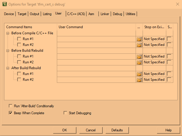

we need to add an after-build user-command in a Keil project.
It's present in Options for Target - User - After Build/Rebuild  Capture.PNG
Is it supported by our SDK generators?
What yml records are responsible for it?

Hi  Andrej Butok,
This feature is supported on generator branch: develop/mcu_sdk_generator
You can set command with "postbuild" tag. Here is an example:
configuration:
  tools:
    mdk:
      postbuild: # add your command
If it does not work on your side, please create a jira ticket for me to port the feature.
