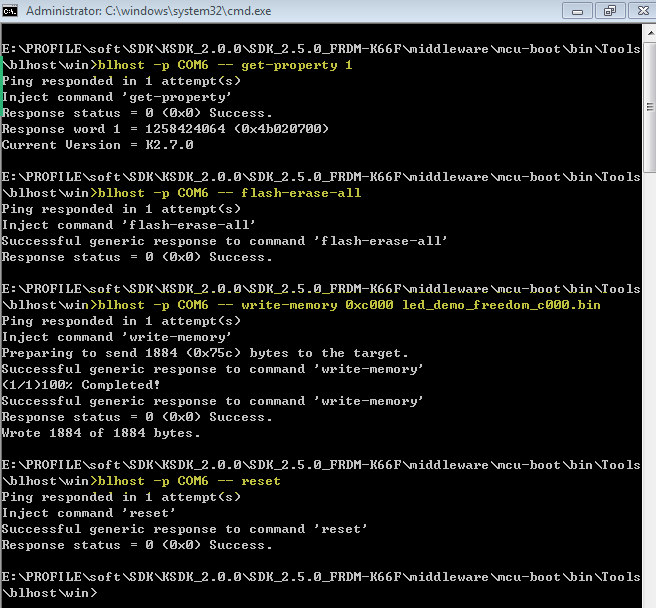

Hi Beth,
    This is the blhos with usb port result:
So, both blhost and KinetisFlashTool works OK on my side, I also use the newest SDK, that's why I recommend you use my generated .bin file directly.
Please try it again on your side.
Kerry

kerryzhou
Hi Beth,
   Thank you for your updated information.
   Answer your question:
1.Why would the LED demo program (alternating blue, red, green) run if I haven’t loaded the .bin file for this demo?
   Do you mean after you download the bootloader, then the LED works automatically?
   If yes, this situation should caused you already download the app in the 0XC000 before.
   You can try to use : unlock kinetis, in the JLINK commander, then download the the bootloader again, the app can't work now, because no APP.
2.Why can’t the blhost.exe program erase everything?   It says it does, but the proof isn’t there from the output you sent.
  You need to use the erase command in the blhost, it won't do it automatically.
Wish it helps you!
Kerry

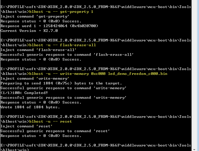

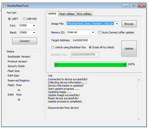

kerryzhou
Hi Beth,
   What the bootloader you are using now?
    As you know, the K66 don't have the ROM bootloader, so you need to use the flash bootloader, you can use the freedom_bootloader in this folder:
SDK_2.5.0_FRDM-K66F\boards\frdmk66f\bootloader_examples\freedom_bootloader
  Now, please note, this project default relocated address is 0XA000, if you want to relocate to 0XC000, please modify the bootloader_config.h
  #define BL_APP_VECTOR_TABLE_ADDRESS 0xc000
Then, this bootloader will relocate the app to 0XC000.
You can build and download this bootloader to your K66 at first.
Now, you can use the blhost or kinetisflash tool to download your app code.
Before you download you app, you need to modify your app, and relocate it to 0XC000, you can use this project:
SDK_2.5.0_FRDM-K66F\boards\frdmk66f\bootloader_examples\demo_apps\led_demo_freedom_a000
Then generate the .bin or .hex code, use the blhost or kinetisflash tool to download it.
This is my test result:
You can find my test result, no errors, it works ok on my board!
I also attach my bootloader and app code for your reference. All relocate to 0XC000.
Wish it helps you!
Kerry

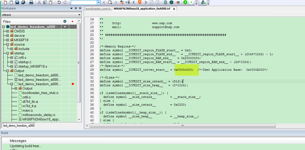

beth_altshuler
Hi Kerry,
Thank-you for your reply.  I am still not able to get the led demo app to download.  I also found some other problems with blhost documented below.   Thank-you for your assistance.
Beth
I had originally tried sending the app to address 0xA000, but would receive the error of 'kStatusMemoryRangeInvalid'.  I am running the freedom bootloader as you mentioned on the demo board.

I made the change to .icf, and tried again, but get same error.
/*-Specials-*/
define symbol __ICFEDIT_intvec_start__ = 0x0000C000; //  WHAT WAS HERE  = __ICFEDIT_region_FLASH_start__;
/*-Sizes-*/

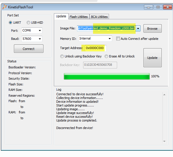

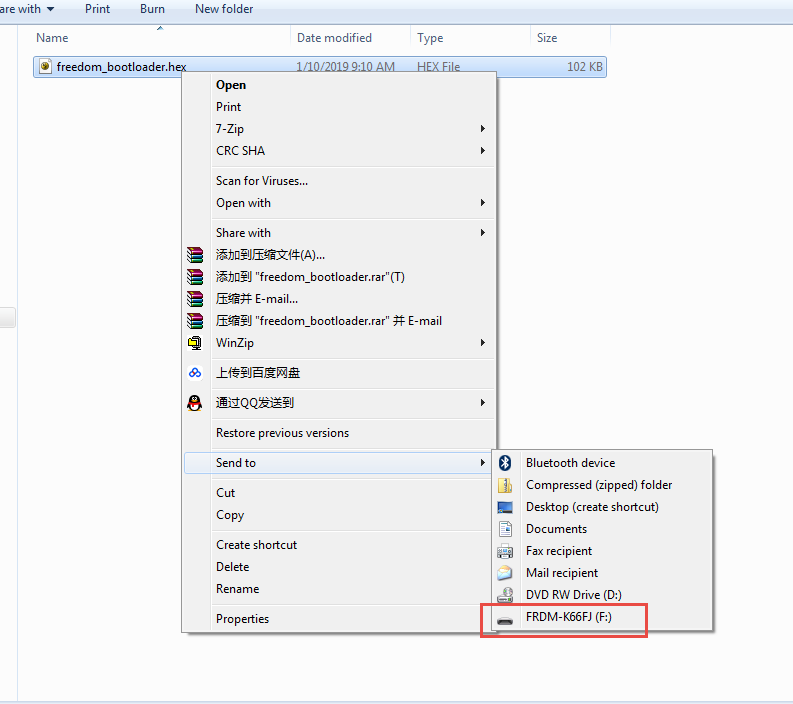

kerryzhou
Hi Beth,
     Please use the my bootloader code and the app code which located to 0XC000, that works OK on my side with KFT, after reset, you need to wait about 5 seconds, then the led will blink.
   1. Download freedom_bootloader.hex.zip to your K66 chip, this is the bootloader code.
    2. Press the reset button, then use the KFT to connect your K66 chip with uart, and download the my app:
led_demo_freedom_c000.bin.zip
  This code works OK on my side, please try my generated files.
  Whether it works OK on your side or not?
   If it still can't work, please check your NMI pin, whether it is high during reset?
Kerry

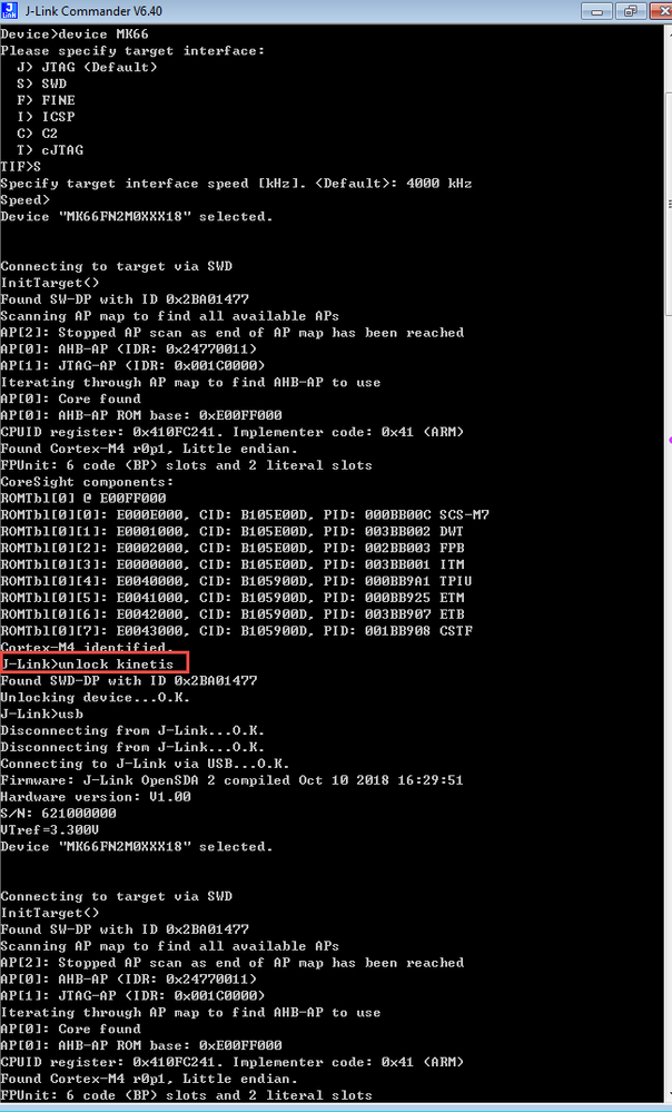

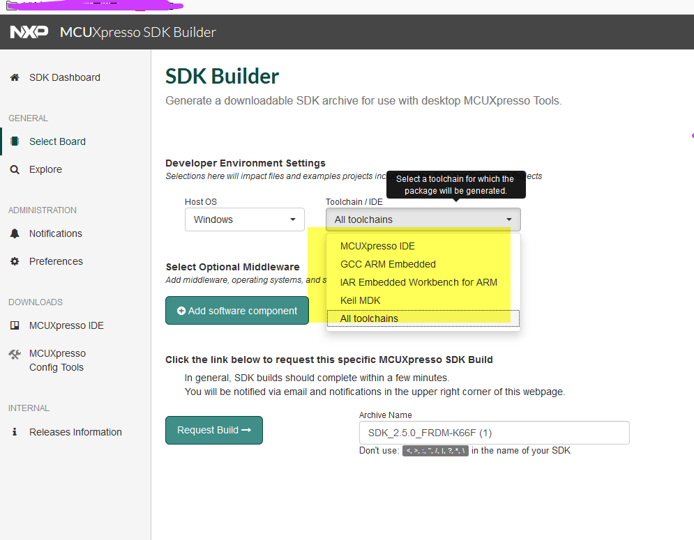

  You said you are using KDS, but in the SDK generated tool, the toolchian IDE don't have the KDS version, how you generate it? Maybe you need to use the MCUXrpesso IDE instead of the KDS:
 If your FRDM-K66 board on board debugger is using the JLINK firmware, you can use the JLINK commander to do the mass erase at first, then just follow my way to test my generated code, after make your board works, then we can check more details:
1. Change the opensda firmware to JLINK firmware, please check this link:
  www.nxp.com/opensda
2. use JLINK commander(find in the JLINK driver) to do the mass erase: unlock kinetis
3. Send my file:freedom_bootloader.hex to the FRDM-K66FJ
4, Then open the kinetis flash tool, also use my led_demo_freedom_c000.bin
After updated it, wait about 5 seconds, the led will blink.

kerryzhou
Hi Beth Altshuler,
   This is the blhost using the com test result:
Kerry

kerryzhou
Hi Beth,
   Sorry, it's just mistyping, I have tested the K66, you can check my first reply:
