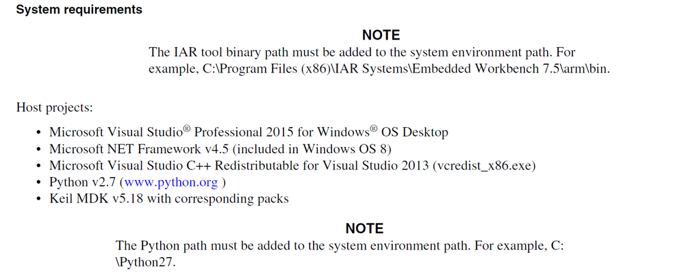

Did you use the IAR? What is your Python version? The 2.7 is the recommend version. Please make sure.
