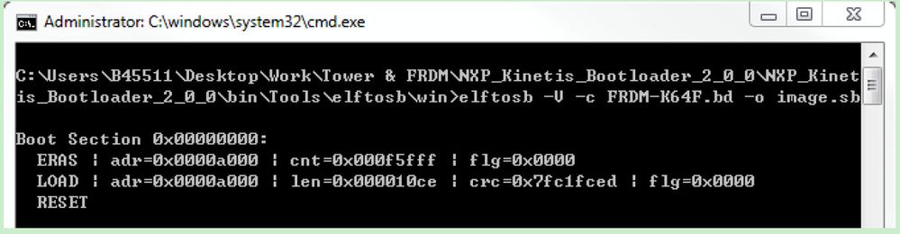

I would like to find a fairly simple example that would walk me through the steps from one of the  example programs through to loading the program on to an FRDM-K22F via the USB-MSC interface. At this point I have compiled and loaded MCUBOOT and have compiled the frdmk22f_led_demo_freedom_a000 demo to get the corresponding axf file. (I presume that the axf is compatible with elftosb.) Now, I need details to get me from there to the sb file.

Hi  David Pfaltzgraff,
   Attached file is from the FRDM-K64 USB MSC, you can refer to it.
   You need to use the KBOOT2.X, and use your app.bin, the bd file to generate the sb file at first.
   You can refer to Kinetis Elftosb User's Guide.pdf in the SDK MCUBOOT doc, or the KBOOT2.0 doc.
   Modify the .bd file content as:
sources {
  # BIN File path
 myBINFile = "hello_world.bin";
section (0) {
  #1. Erase the internal flash
 erase 0x0000a000..0x00100000;
 #2. Load BIN File to internal flash
 load myBINFile > 0xa000;
 #3. Reset target.
 reset;
Copy the bd file and the app.bin to the elftosb.exe location:
~\NXP_Kinetis_Bootloader_2_0_0\NXP_Kinetis_Bootloader_2_0_0\bin\Tools\elftosb\win
Input:elftosb –V –c FRDM-K64F.bd –o image.sb”
Then, press the bootpin(PTB17) hold it and press the reset, you can find it from the bootloader, connect two usb cable to your board, you will find your board will be a FSL Loader disc, then drag your .sb file to it, you will find your app works.
Wish it helps you!
You can try it on your side.
If you still have questions about it, please kindly let me know.
