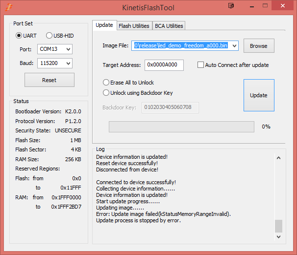

When I try to debug the freedom_bootloader, I get this error. If the bootloader is in Release form, it works well and succeed in flashing the bin file.
carlosmendoza‌, I tried following your link here, but I'm stuck due to that issue...
Same for my application I flash in address A000. If it is a debug version, it will not succeed (this I read in some post here, but I did not think it applies also to the bootloader...).
Any ideas?

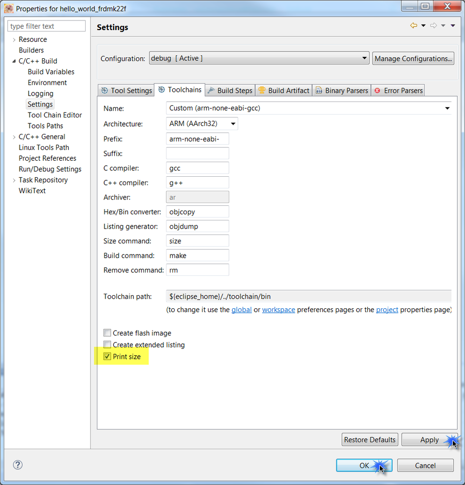

Hi Roy,
I believe the problem is caused by the size of your bootloader project, it is bigger than the available memory. You could try printing the size information in KDS and then compare the sizes in both Debug and Release targets:
Hope it helps!
