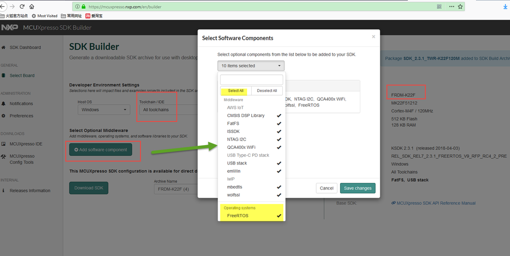

hello everyone,Whether there is MK22FN512 FreeRTOS software development kit.I would like to port FreeRTOS to K22. I would like to ask if there is no porting document. Thank you
2,518 Views
kerryzhou
Hi Customer,
    You don't need to port it by yourself, because we already have the FreeRTOS code in the KSDK for MK22 chip.
  Please download the SDK code from this link:
Welcome | MCUXpresso SDK Builder
Select the chip which you want, then note the following steps:
Select the FreeRTOS, then download the code.
You can find the freeRTOS code in folder:
SDK_2.3.1_FRDM-K22F\boards\frdmk22f\rtos_examples
Wish it helps you!
Kerry
