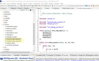

kerryzhou
Hi @gayans ,
   As I know, just simple app sdk example iled_blinky as the APP, is not enough, as the APP also need the related header to match the mcuboot_opensource.
  You can test this code as the APP, this matches to the mcuboot_opensource:
  SDK_2_11_1_EVKB-IMXRT1050\boards\evkbimxrt1050\lwip_examples\lwip_httpssrv_ota_enet
  After it works, then you can check the related header.
Wish it helps you!
