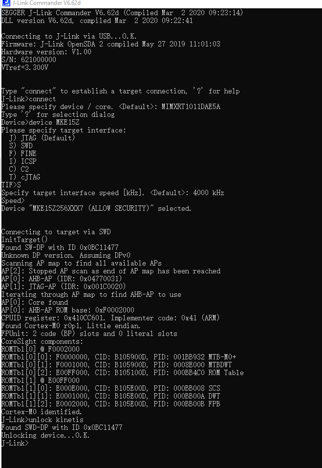

kerryzhou
Hi Cleber Akira Nakandakare,
    The normal unlock result should like my following picture, it is from the FRDM-KE15Z board.
If your board even can't be unlocked, the mass erase maybe also disabled.
If you didn't do the secure operation, you need to read this pdf:
https://community.nxp.com/servlet/JiveServlet/download/859331-1-397057/Kinetis+Lock+issue+analysis+a...
Check whether you meet all the related requirement, the solder temperature, the debugger wire, etc.
When you first time use the board, it works OK right? Just after the ROM bootloader mass erase, then the debugger can't connect?
Do you have FRDM-KE15Z board on your side, can you use the same step and reproduce it in the NXP official board?
If you can reproduce it, I will check it on my side.
Kerry
