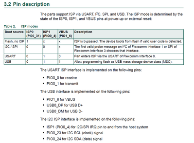

Pls refer to section 3.2 Pin description as following fig, I copy from the UM11071.pdf.
If you do not want to enter ISP mode, pls connect a pull-up resistor on the PIO0_31 pin, in this setting, the ISP mode is bypassed, the LPC51U68 will execute application code directly.
Hope it can help you

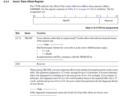

Please advise how can external MCU initialize the Vector Table Offset Register?
What is the command(s) external MCU can use?
CK
2,723件の閲覧回数
xiangjun_rong
Pls note that the two images are different.
When you develop source code which generate image1, you can initialize the Vector Table Offset Register as 0x00.
When you develop source code which generate image2, you can initialize the Vector Table Offset Register as the sector address, the last 6 bits are reserved.
