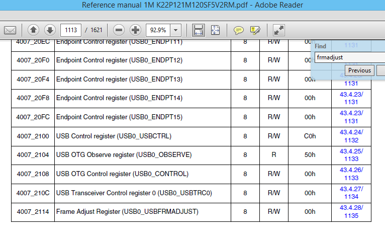

But it seems like there's a fundamental difference in the clocking scheme, where MK22F-512 calls "usb_clock_init" and sets the following:
    // need to set the clock_recover_en and irc_en register
    USB0->CLK_RECOVER_CTRL |= USB_CLK_RECOVER_CTRL_CLOCK_RECOVER_EN_MASK;
    USB0->CLK_RECOVER_IRC_EN |= USB_CLK_RECOVER_IRC_EN_IRC_EN_MASK;
Well, MK22FN1M0XXX12 doesn't have those registers.
Specifically in MK22FN1M0XXX12 Reference Manual and header MK22FA12.h, it stops at USBFRMADJUST.
  __I  uint8_t OBSERVE;                            /**< USB OTG Observe register, offset: 0x104 */
       uint8_t RESERVED_23[3];
  __IO uint8_t CONTROL;                            /**< USB OTG Control register, offset: 0x108 */
       uint8_t RESERVED_24[3];
  __IO uint8_t USBTRC0;                            /**< USB Transceiver Control register 0, offset: 0x10C */
       uint8_t RESERVED_25[7];
  __IO uint8_t USBFRMADJUST;                       /**< Frame Adjust Register, offset: 0x114 */
#if MY_HACK
       uint8_t RESERVED_26[43];
  __IO uint8_t CLK_RECOVER_CTRL;                   /**< USB Clock recovery control, offset: 0x140 */
       uint8_t RESERVED_27[3];
  __IO uint8_t CLK_RECOVER_IRC_EN;                 /**< IRC48M oscillator enable register, offset: 0x144 */
       uint8_t RESERVED_28[23];
  __IO uint8_t CLK_RECOVER_INT_STATUS;             /**< Clock recovery separated interrupt status, offset: 0x15C */
#endif
} USB_Type, *USB_MemMapPtr;
When avoiding to set the non-existing USB registers, I could continue to load the project.  But unfortunately the KinetisFlashTool doesn't recognize the device, neither as COM PORT (doesn't come up as something that Windows recognize), nor as HID device (0x15A2,0x0073).

Hi Ping,
Sorry I uploaded the wrong directory.  Yes, I changed the flash size for 1M0 board when porting from 512.
Anyways, I will try to port now from K64_120 now and will write down the exact steps.  In the mean time, can you please look up/comment on how to port the "usb_clock_init" from either hardware_init_MK64F12.c or hardware_init_K22F512.c?  Both of these processors have this *CLK_RECOVER_CTRL* registers on their USB Memory Map.
Whereas the K22F_1M0 doesn't have anything after USBFRMADJUST.  Needless to say, I got a Hard Fault when trying to set this.
Maybe there's another file I can port for this part?
Cecylia
