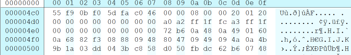

rtoma
I seemed to have cracked it. But I have a question (see below).
In the binary file, the first 4 bytes are the SP and the next 4 bytes are the program counter. Hence an execute command will look like:
blhost -p /dev/ttymxc2,56700 -- execute 0x000004E9 0 0x20012000
(see below the reason for choosing these addresses)
So here is my question:
in the .map file the start is presented as 0x000004e8                Reset_Handler
Why is the start address incremented by one in the binary file?
4,528 Views
jorge_a_vazquez
Hi Radu Toma
Sorry for the late reply, please look for information about Pointer to function in Thumb state "ARM". For more information please check the following post:
Thumbs up with Assembly on ARM Cortex | MCU on Eclipse
Hope this could help.
Jorge Alcala
4,527 Views
rtoma
Thanks Jorge! Clear and concise explanation.
