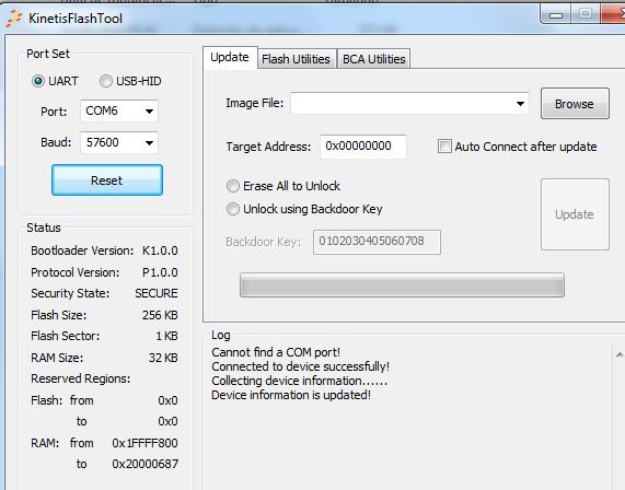

The first thing I did after powering my fresh chip for the first time was connecting to bootloader using the FlashTool. It connected as expected but the "Security State" field was marked as "SECURE". I attached a picture with information that's show in the FlashTool connection screen.
Tried blhost and queried for available commands, it returned "Available Commands = flash-erase-all, flash-erase-region, read-memory, write-memory, flash-security-disable, get-property, execute, reset, set-property, flash-erase-all-unsecure"
I guess the only command I cant use at this point is "flash-erase-all-unsecure". It returned:
"Ping responded in 1 attempt(s)
Inject command 'flash-erase-all-unsecure'
Successful generic response to command 'flash-erase-all-unsecure'
Response status = 0 (0x0) Success."
Despite of that, chip still marked as SECURE connecting to it right after the erase command. Tried "read-memory" also but with same response about enabled security.
This on arrive SECURE state was a surprise for me. Clearly a bug/defect either on the user manual, the bootloader (in case it turned security ON by itself), or at the factory while formatting/initializing this chip, anything else:
I think is weird that it reports Flash Reserved Regions 0x00 - 0x00. Same result with blhost command "get-property 12". Maybe because chip is secure, it doesn't even read this information? Or maybe I managed to damage the flash? :smileysad:
Any clue about what I should do to unsecure the chip from now?

ramboyang
Hi, Rodrigo,
1. I am not clear about the default factory setting of the chip, it is beyond BootROM scope. maybe the entire flash are all 0xFFs, in this case, the device is under secured state(FSEC=0xFF).
2. The Flash security state is determined by FSEC register, which is loaded from 0x40C during HW power up sequence, and cannot be changed by any SW codes, so even with flash-erase-all-unsecure command, a  subsequence reset command is required to refresh the FSEC register.
3. The reserved region 0-0 means there is no reserved region on the internal flash, in other words, the entire flash is availabe to be programmed.
Hope about info helps.
Have a great day!

rodrigon_hernan
Update:
It seems that I really damaged the chip, or other thing happened. I soldered a second chip and I got "UNSECURE" flag upon first contact.
I had to rework the first one, had issues while soldering and it was quite stressing. Chances are I just killed some of the flash or something.

ramboyang
Hi Rodrigo,
Based on the phenomenon described above, it looks like the  opearating temperature exceeds the soldering temperature mentioned in datasheet, so the FTFA may be demaged forever, though the chip still can work sometimes,it can no longer work stably.
This guess can explain why the second K17 works normally on your board, and why we never saw this issue on the NXP Freedom board.
Hope it helps.
