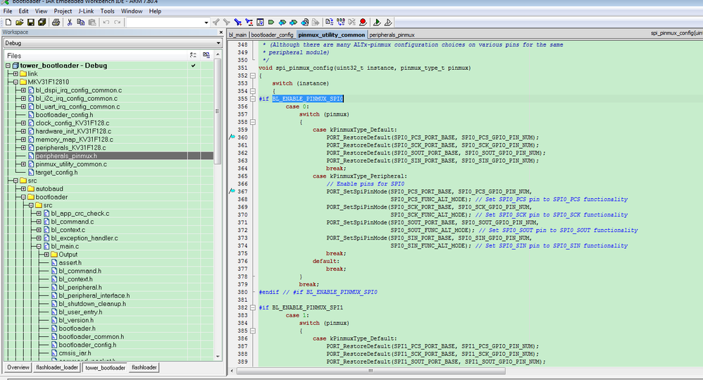

Is it possible to run KBOOT on a different interface than SPI0? I'm using a MKV31F128 - the user guide seems to say that the bootloader must use SPI0 on PTE.

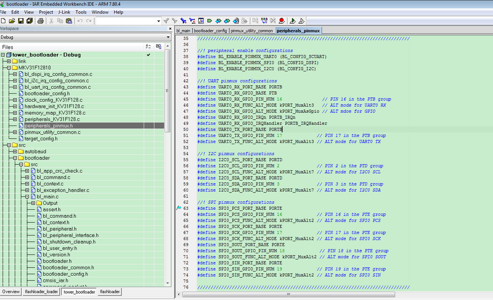

Hello Dan Foster,
   Of course you can use other SPI module.
   You just need to modify the according SPI0 and pin to the module which you want.
   You can check the KV31 bootloader code.
   You will find the spi is defined in file, peripherals_pinmux.h and pinmux_utility_common.c.
Wish it helps you!
If you still have question, please let me know!
