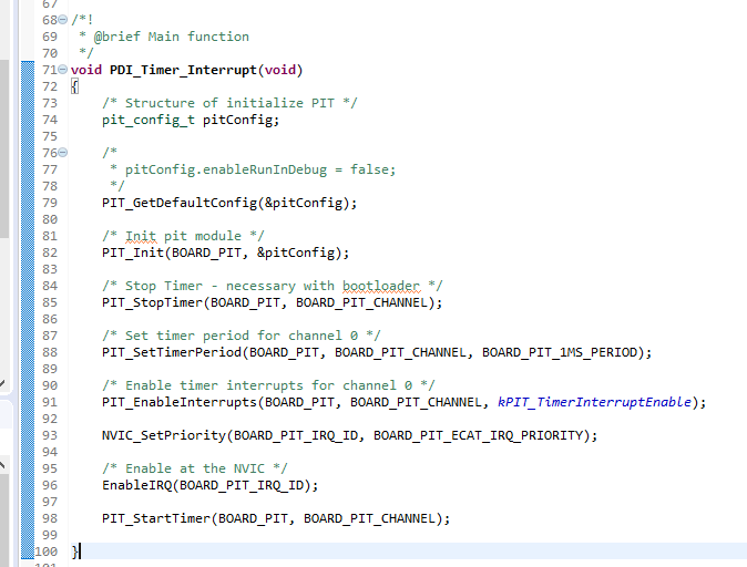

I developed on K66 an application using FreeRTOS, and flashed to MK66FX1M018 work fine (debug and release version).
Now I have downloaded KDS bootloader 2_0_0 and flashed to K66 at start address 0xA000 (I use only USB for download app), I connect through USB using KinetisFlashTool for download application and all seems to be fine. But when the app start initialize the display correctly but the task (USB, MODBUS and other) doesn't start.
Where could be the problem ???

Hi Daniel,
the application work under FreeRTOS and on begining (out of task) I initialized del alphanumeric display.
When the boot-loader jump to application I see the alphanumeric display initialised but the task do not start (I see through a led on my task), but after 1-2 minutes the task run and the application work fine.
This problem occur in only with the boot-loader, I have not seen this issue  if I load application directly.
I hope I have explained clearly
At your disposal for more information.
Marco
7,287 Views
danielchen
Hi Marco:
I guess the PIT timer is initialized  during boot time, and in your application, this timer is initialized again though this PIT is still running. My suggestion is you need to reset/stop the PIT timer before you  use it again. So your solution can work.

I discovered that the application start to work after about (more or less) 1 minutes. So after a long debug and trials I found that the problem was probabily on the function "void PDI_Timer_Interrupt(void)", to resolve the issue I had to add
"PIT_StopTimer(BOARD_PIT, BOARD_PIT_CHANNEL);"
Could be this the solution on my issue ?
Marco

mpazzi
Hi Daniel,
the application stand alone is work fine, so why the issue is on application ? The problem start when from bootloader jump to application, so it could be some bootloader configuration that goes against the application ?

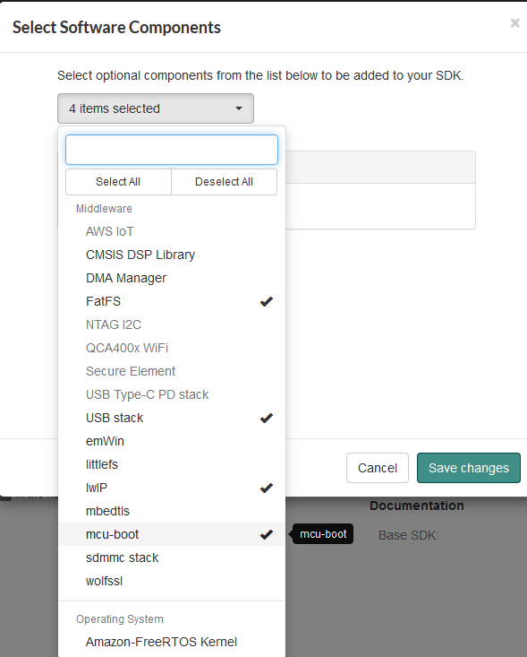

danielchen
Hi Marco
I don't understand why you use MCUXpresso IDE, but use KDS bootloader.
NXP released MCU BOOT for MCUXpresso  IDE.  I would suggest you try to use the lastest bootloader.
Please download MCUXpresso SDK for K66 from here
Welcome | MCUXpresso SDK Builder
Please make sure mcu-boot is selected before you downloading the SDK.
The boot loader example is located at
SDK_2.4.1_FRDM-K66F\boards\frdmk66f\bootloader_examples
Please use the latest MCUXpress IDE 10.2.1, you can download it from here
MCUXpresso IDE|Eclipse-based Integrated Development Environment (IDE)|NXP
