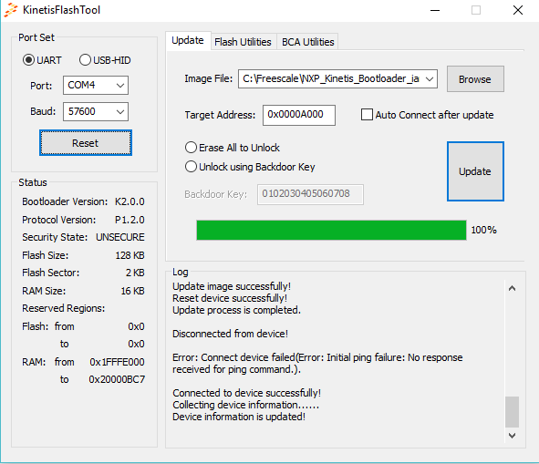

I´m using k02 - 128 Kb. I can connect and download firmware with KinetisFlashTool. But after download new firmware it no start, my hardware remains in bootloader firmware ( I put a toggle led to test this).

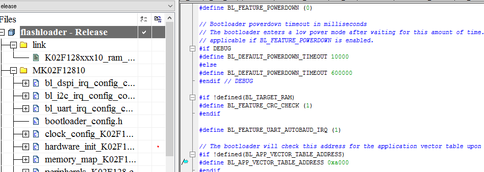

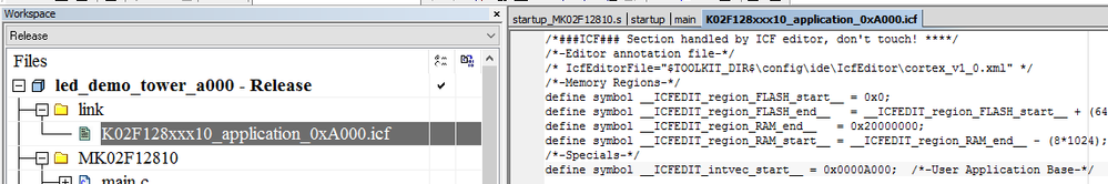

I do offset to 0xa000 in KinetisFlashTool and use led_demo_tower_a000. I test led_demo_tower_0000 and in this case I lost my bootloader. Because it I think that the problem are in memory map.

4, use KinetisFlashTool to download the .bin file in NXP_Kinetis_Bootloader_2_0_0\apps\led_demo\MK02F12810\iar\binaries\led_demo_tower_a000
    Before you test led_demo_tower_a000, I suggest you test led_demo_tower_0000 on your board at first, whether it can work without the bootloader.
5. After download the app file with bootloader, then reset the board, wait a moment, check the app function.

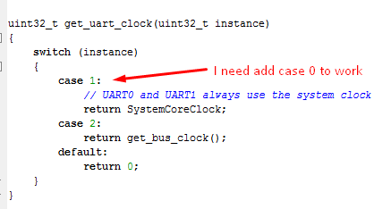

First: I use in my board UART0 and the exemple code have a "case" that no into in "case 0".
I need changer other points too to preparete firmware to UART0.

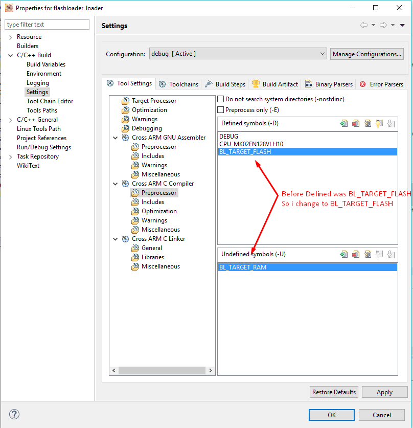

I solved it changing my project to KDS, because it have more interface features. With KDS I observed that BL_TARGER_FLASH macro was not being used. So I need change it.
Now my bootloader work in KDS, I still have make work in IAR.
