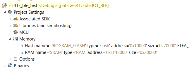

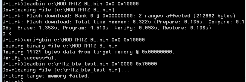

My application on R41Z , debugging is ok, then I want to load application on top of boot loader.
Our boot loader is located from 0x0, size 0x10000
Application from 0x10000, size 0x70000
But loadbin out application always fail, what could be wrong on setting?

It would appear that the applications it's not being flashed in the correct section, did you modified also the linker file or something else?
I would recommend you to use one of the available examples code like the ota_bootloader or the fsci_bootloader available in the SDK.
Also, please check the BLE Application Developer's Guide and the BLE Demo Applications User's Guide for further details on the topic.

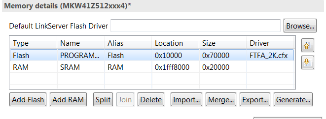

kevin_lang
Many thanks Estephania,
I changed the setting via MCUXpresso on the memory , it shows new value,  but actually has no effect
After changed linker file, everything is fine
