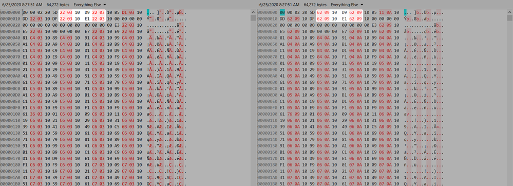

I am using cortex-M7 MKV56F1M0xxx24 with a custom boot-loader to update application in flash.
Refer to the attachment to know the memory layout used.
1. Is it possible to build a single binary and be able to flash it to both Primary and Secondary area?
If yes, Lets say I want to flash binary to Secondary area, would it need to be specified to start at secondary area during compile time?
2. How do i flash the binary to Secondary area even if the binary is built to start from Primary area? What are the things to be taken care of? (like IVT offset... etc)

I want to clear the 1st question. below is the problem statement.
While compiling the application, offset address needs to be provided in the linker script.
The binary file generated for the application contains this offset address at various places including Interrupt Vector Table.
Attached is a sample binary comparison of 2 application binary files, left one built for offset address 0x32000 (primary area start) and the right one at 0x96000(secondary area start).
Because of this, application compiled with offset address 0x32000 will run only if it is placed in Partition 1 and application compiled with offset address 0x96000 will run only if it is placed in Partition 2.
We are unable to generate one application binary file which can run from both Partition 1 and Partition 2.
The requirement is that we should be able to run same application from either of the partitions.
Thanks in advance.
