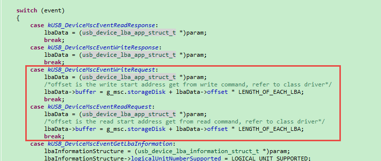

I can able to copy the content into iMXRT (MSD)treating my PC as HOST & iMXRT1050 as a device. 4KB memory space is available for transferring data.
I was working on Example "evkbimxrt1050_dev_msc_ramdisk_bm" downloaded from SDK example program.
I can able to transfer the file into MSD of iMXT1050 at Endpoint address "2 ". I got to know this by debugging the code. keeping breakpoint @ usb_status_t USB_DeviceTransfer(usb_device_handle handle,uint8_t endpointAddress,uint8_t *buffer,uint32_t length).
I am stuck at this point. I need to copy the data from the buffer to flash memory. I don't know how to do this.
Challenges faced.
-->I can't keep the code stopped by breakpoint for more than 3 minute due to the timeout function the drive(POPS up in PC) gets deleted automatically.
--> I can able to identify the data stored address in RAM memory @ 0x20001cdc. But it is dynamic in nature.
What I needed.
I just want to know where the transferred data in MSD located and how to copy the data from that location to ROM.

1) Please receive and transfer data via responding to the below USB events.
2. To implement the flash programming, it needs to run the code in the RAM or SDRAM prior to utilizing the FlexSPI driver to make it.
