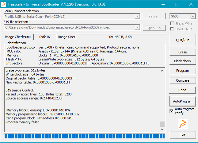

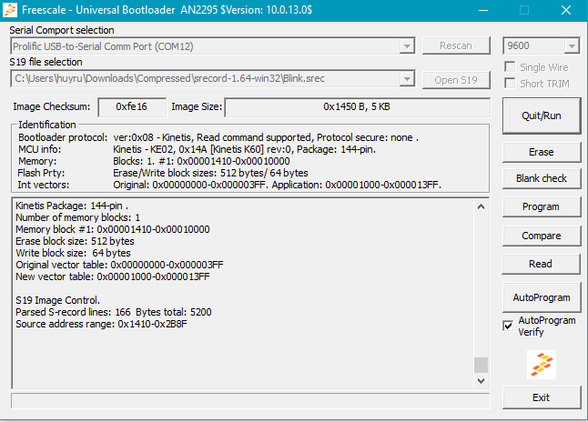

huyrua291996
I try to use bootloader as AN4767 in my processor MKE02Z16VLC4 (40MHz)
After program bootloader to my processor, I use win_hc08sprg.exe to flash Blink app to my processor
and I get the result
After that, I use S-recoder tool to convert source address range of my Blink.srec, i get a new result
So it still not work. How should I do now

huyrua291996
Hi Alice,
I've fixed some mistake about my UART and when I debug, the address, length and the data is right.
But after Flash_EraseSector, I got the problem
And I dont know why this error is occurred. The Flash_EraseSector function work fine in my simple project (only write 'a' in address 0x00001410).
Can you help me. My code write for KE02 40MHz and can you use FRDM-KE02 (40MHz) debug for me

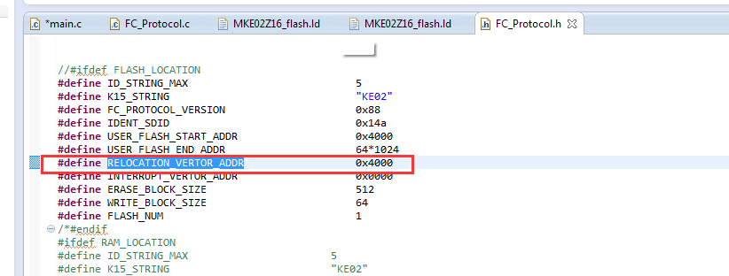

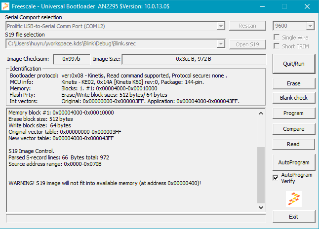

Hi Huy,
Please pay attention that, the flash size of your chip MKE02Z16VLC4 is 16K 0x0000 - 0x3FFF,
so you can't put the new vector table(APP vector ) into 0x4000 .
Also please refer to AN4767->2.4 User code to configure your APP.
If still have problem, I recommend you open the bootloader GUI win_hc08sprg(it under AN2295 ) project to debug ,
the information from GUI view can find in the GUI project source.
Hope it helps

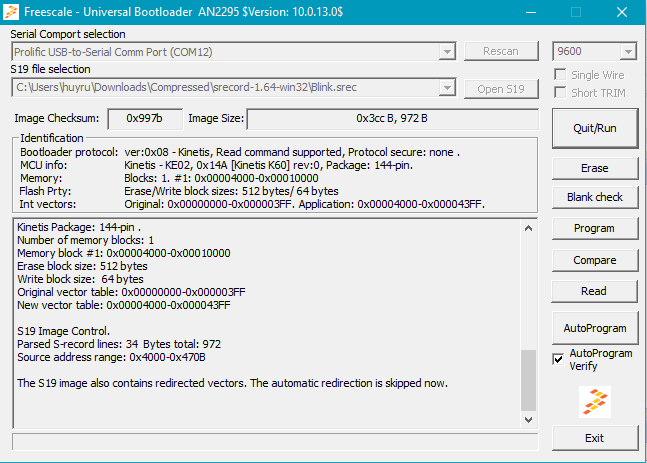

huyrua291996
Hi Alice,
I've changed in FC_Protocol.h and I also change the linker file in my application code
Can you review for me both project in CW
I also use AN2295 GUI and it 's seem wrong
It's wrong in Memory Block. In the Identification it's Block 1 and when erase and write it's Block 0
What should I do

Hello Huy,
I haven't the board about your chip, so I can't debug it on my side.
From the message , it seems erasing failed, please set a breakpoint in your erasing code,
then click "Erase" button, when it run to breakpiont, debug step by step check whether it erased
successfully , or why it failed.
Alice
