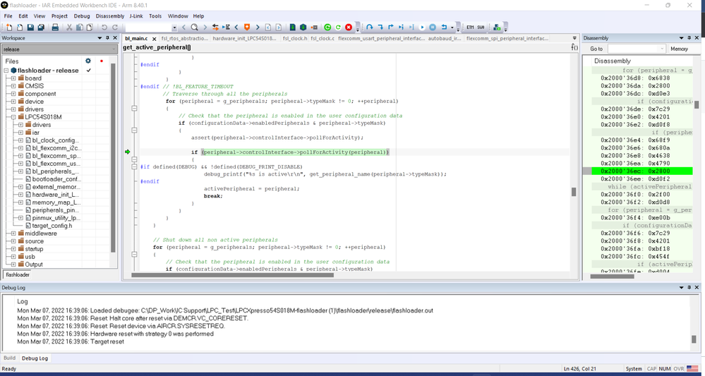

I need your help to set up the flash loader via IAR, and plan to create a flash loader to do internal flash programming via SPIFI.
I have downloaded the flashloader project and try to run it on IAR.
When I run download and debug via J-Link, and it always stuck in peripheral checking.

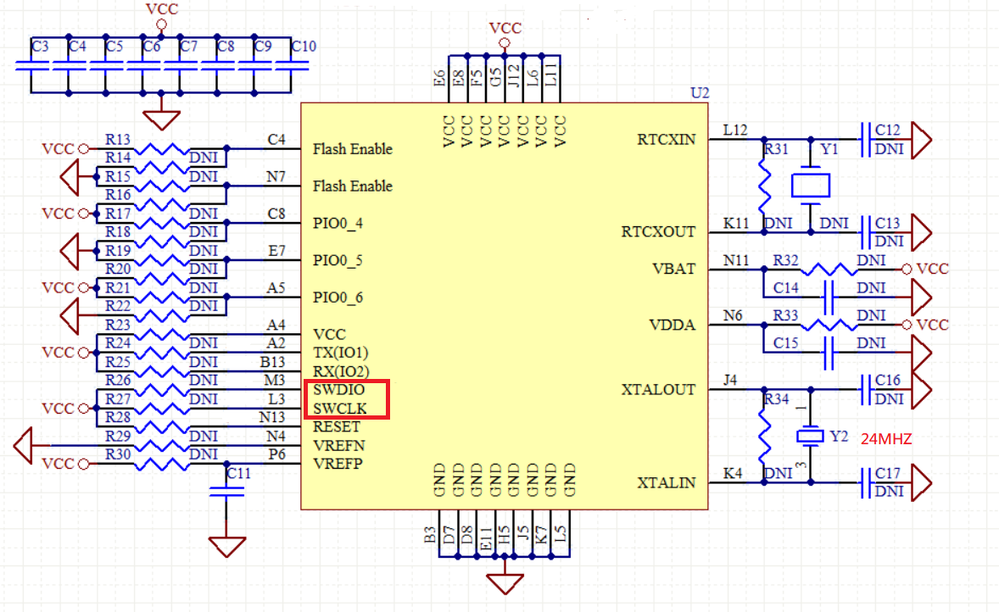

I guess my hardware design is not compatible the bootloader, and maybe I need to remove some instructions. There is the hardware design on our programming board. Could you help to give us some suggestions?

jackhsu
Hi Alice,
The issue is solved because we modify initialize.
Thanks.
3,467件の閲覧回数
Please first check the external flash work well, you can use spifi demo under SDK.
Alice
