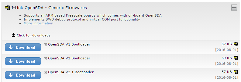

Hi Grant,
You are right. As I mentioned above, the k20dx128_twr_k65f_if_0x8000.bin​ is not the correct firmware. That's why the installation was unsuccessful.
Before the correct firmware is available, you might want to install JLink v2 firmware on your board, available from JLink OpenSDA website. You should look for the OpenSDA V2 Bootloader as shown below.
The Jlink V2 firmware supports Segger JLink debugging on KDS, IAR and Keil MDK and has virtual COM port, although it does not have the drag-n-drop MSD programming as the default version does.
Roy
