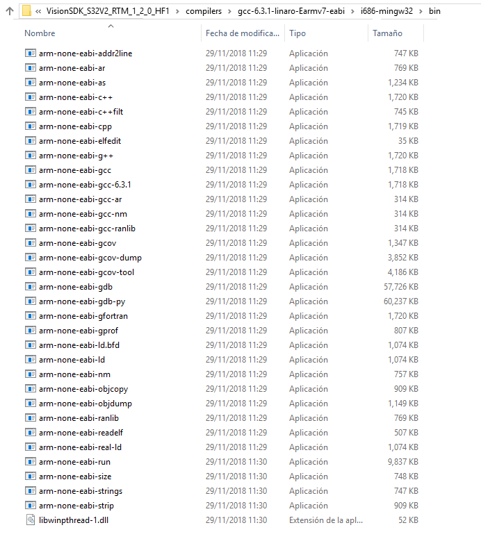

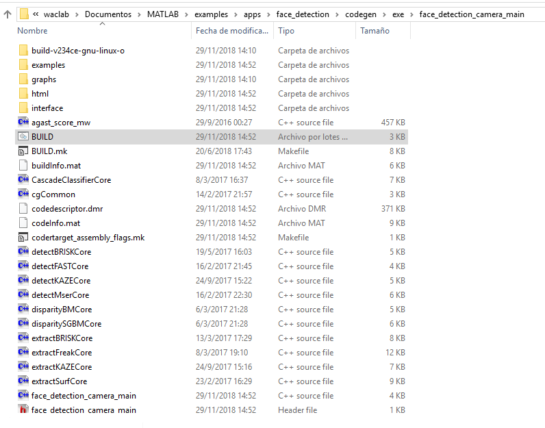

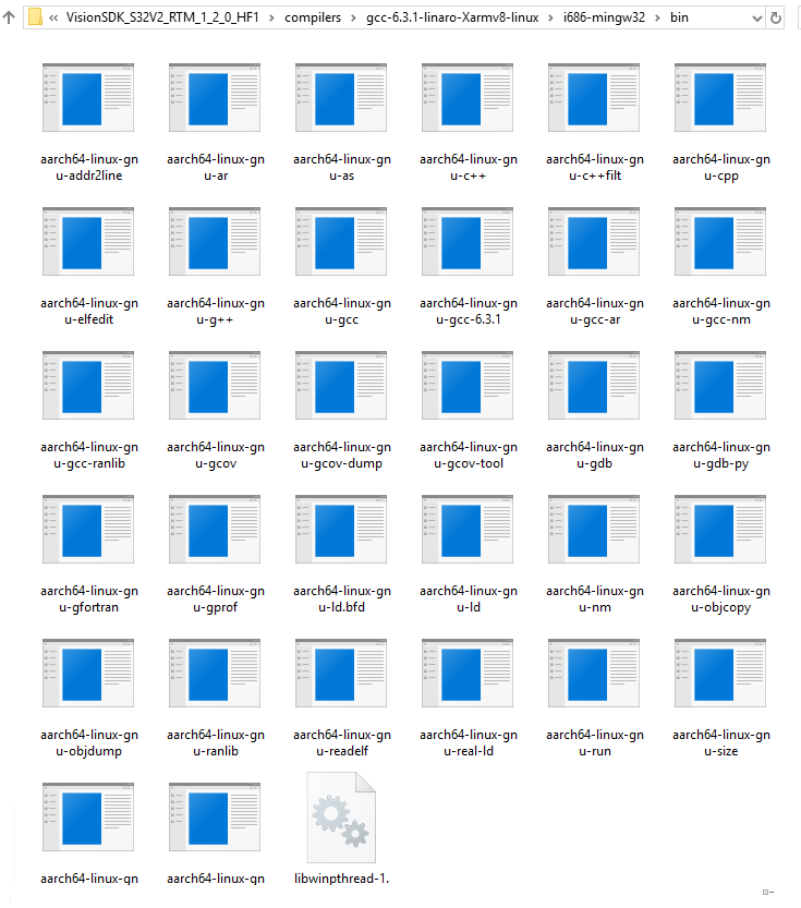

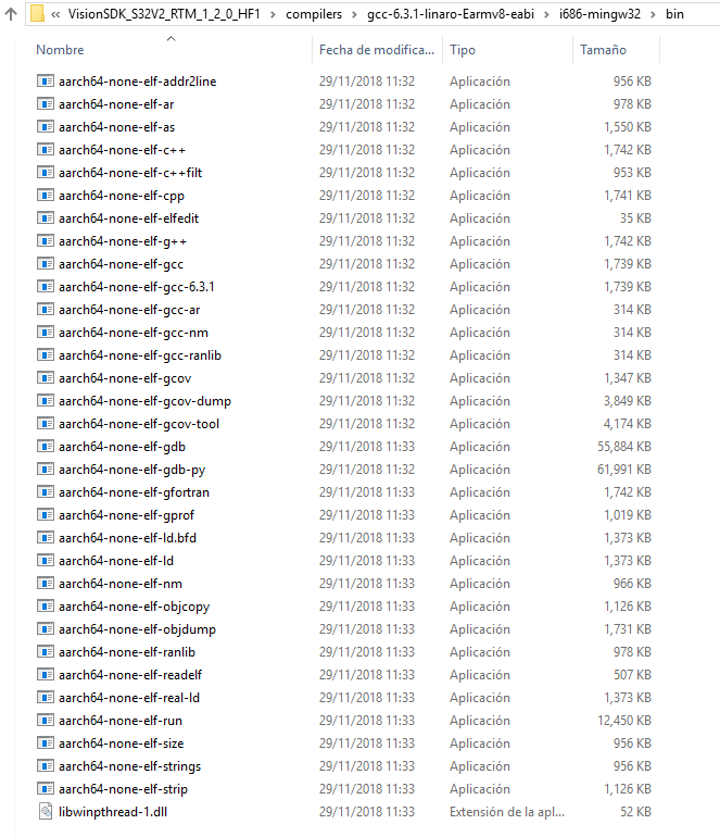

Could you give me the BUILD.bat file from C:\Users\waclab\Documents\MATLAB\examples\apps\face_detection\codegen\exe\face_detection_camera_main\ ?
Also I want to see the contents of:
C:\\NXP\VisionSDK_S32V2_RTM_1_2_0_HF1\compilers\gcc-6.3.1-linaro-Earmv7-eabi\i686-mingw32\bin
C:\NXP\VisionSDK_S32V2_RTM_1_2_0_HF1\compilers\gcc-6.3.1-linaro-Earmv8-eabi\i686-mingw32\bin
C:\\NXP\VisionSDK_S32V2_RTM_1_2_0_HF1\compilers\gcc-6.3.1-linaro-Xarmv8-linux\i686-mingw32\bin

willcampo
24,111 Views
willcampo

The compilers files look fine.
I want you to post a message with BUILD.mk file attached to that meesage. Or paste the content of the file.
