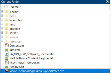

nxf40536
I have added a patch that should cater to your problem. All you need to do is run the archive (password is 'nxp') in the root of the toolbox:
and overwrite the files it prompts you. Then you should be good to go. If you encounter any issues, please let us know.
Thank you,
Vlad Dascau

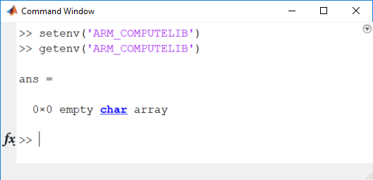

nxf40536
Hi [email protected]‌,
This is a known bug for the 18.05 ARM Compute version. To fix this you should set the ARM_COMPUTE variable to be empty and this way the toolbox will use the bundled ARM Compute library version.
If you encounter any other problems, please let us know.
