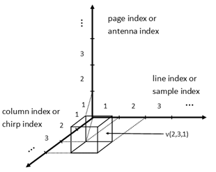

Step 1: Input data
Input data is a 3-dimensional array made up of a demodulated signal. There is a page for each antenna, containing a matrix where each column contains the samples of a chirp.
NOTE: In MATLAB, we refer to the third dimension as pages. For example v(:,:,1) is the first page of v.
NOTE2: A chirp is a signal in which the frequency increases or decreases with time.
Figure 6 Input data structure

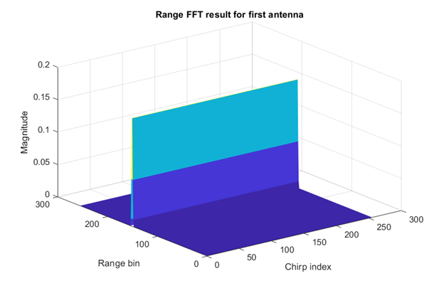

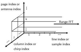

Step 2: Range FFT (Fast Fourier Transform)
The FFT is an algorithm that samples a signal over a period of time and divides it into its fundamental frequency components.
The output array of the range FFT is obtained by replacing each column of the input array with its Fourier transform. From each such Fourier transform one could deduce the ranges of all objects found in front of the radar.
Figure 7 Range FFT
Here is the MATLAB code for range FFT:
% Generate window coefficients for range FFT
% In the radar application, the signals of interest are narrowband
% sinusoids of widely differing strengths (primarily as a consequence of
% the inverse fourth power variation in radar signal strength with radar
% range) and the usage of a window function with low sidelobes is
% crucial for preventing one or more powerful signals from drowning out
% weaker reflectors.
window_rangeFFT = reshape(window('chebwin', M), [], 1);
window_rangeFFT_rs = round_and_saturate(window_rangeFFT, NBITS);
% Generate twiddle coefficients for range FFT
% The user needs only to define twiddles for one octant (- Imaginary, + Real)
% and the SPT logic determines other needed twiddles by real / imaginary
% swaps and sign inversions.
t = (1:M/8)/M;
twiddle_real = round_and_saturate(cos(-2*pi*t), NBITS);
twiddle_imag = round_and_saturate(sin(-2*pi*t), NBITS);
twiddle_rangeFFT = twiddle_real + 1i * twiddle_imag;
% Perform Range FFT
% For each line a FFT is performed. The negative frequencies are discarded.
% The frequencies with significant magnitudes indicates the presents of an
% object at a specific distance. The distance is proportional with the
% frequency.
% Non bit-exact model
exwindow_rangeFFT = repmat(window_rangeFFT, [1, N, P]);
output_rangeFFT = fft(input_data .* exwindow_rangeFFT, [], 1);
output_rangeFFT = output_rangeFFT(1:end/2, :, :) / M;
% Bit-exact model
output_rangeFFT_bitexact = rangeFFT(input_data_rs * 2^(NBITS-1), window_rangeFFT_rs * 2^(NBITS-1), twiddle_rangeFFT * 2^(NBITS-1), M, N, P);
output_rangeFFT_bitexact = output_rangeFFT_bitexact / 2^(NBITS-1);
Figure 8 Range FFT Results

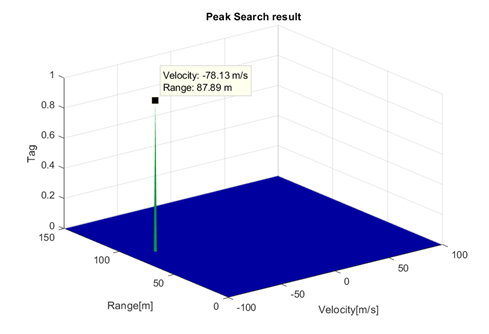

Step5: Range and Velocity
The result matrix contains all detectable ranges(line-indexed), and all detectable velocities (column- indexed). The matrix contains only 1s and 0s. Each element that has the value 1 corresponds to at least one detected object and its velocity and range are given by its coordinates.
So, if we use this plot we will get the following image:
figure; mesh(max_velocity * (-N:2:N-2)/N, max_range * (0:2:M-2)/M, output_peakSearch_bitexact);
title('Peak Search result');
xlabel('Velocity'); ylabel('Range'); zlabel('Tag');
Figure 12 Peak search result
This shows an object coming towards the radar with 78.13 m/s velocity, being at that moment at 87.89m away.
So, this example shows a simple method for simulating the implementation of a Radar application (starting with a demodulated input, performing range and Doppler FFT and a peak search to get object’s velocity and range, relative to the Radar).
