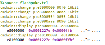

hello
             I have programmed the nor flash with the rcw generated from the pbl tool ,how to read the values that is in the nor flash
when i read 0XE8000000 I am finding 0xffffffff if when  i am executing the commands i was able to read the device id
change p:e8000000 00f0 16bit
change p:e8000aaa 00aa 16bit
change p:e8000554 0055 16bit
change p:e8000aaa 0090 16bit
display p:e8000000..e8000004
display p:e8100000..e8100004
how to find that the code is written to the flash?

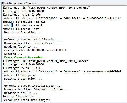

lunminliang
Hello agxin j,
You can either use dump of flash programer or ccs command to read back the flash content.

jagxin
sorry sir the last  snap short attached is for nand flash here is the snap for nor flash

jagxin
Source flash poke.tcl file is given for reading from freescale how is this code working ? To read the flash id is there any way to find if the flash is locked or not by reading

jagxin
thank you sir
it is reading now with mem  command
How this commands are providing the flash id ?
