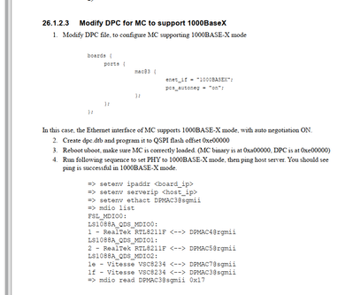

Hi  NXP:
   We want to configure the mode on the LX2160 to specify the network port as 1000base. But I only found the DPC configuration example in the DPAA2 manual. How to configure the kernel device tree.
Tianyi
1,125 Views
June_Lu
The DPC file just means that the SerDes lanes, PCS, PHY configuration is all done in Linux as opposed to the MC firmware.
1,101 Views
wutianyi
Thank you for your reply. We were able to fix it after modifying the DPC.
