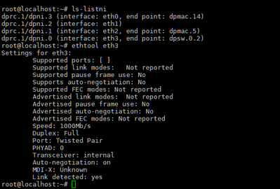

Hi for all !!!
If DPSW is set in lx2160a NPU, ethtool with eth1 does not work properly.
Please see the below for details .
In this case, how can i get the eth link and speed information?
Peter.

Hi yipingwang
Add an additional information :
Link detection and speed information did not change when the ethernet cable was disconnected from eth3 after the ethernet cable was connected to the eth3 port.
Please tell me why the ethernet information is not updated.
And In this case, how can i get the eth link and speed information?
Peter.

Which version LSDK are you using? And What's about the MC version?

yipingwang
Would you please provide more detailed information?
How did you set DPSW?
Please run "ls-listni" command on the target board to show which dpmac eth1 connects to.
Please connect Ethernet cable to eth1 port to check the link status with ethtool.
