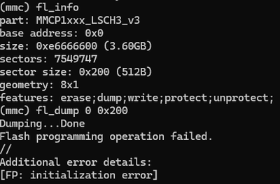

Hi everyone,
I'm trying to program eMMC with cwflash.py but I'm facing an initialization failure even though the command (like fl_dump) completes.
1. What I'm doing:
I want to dump the first sector (512 bytes), so I run:
The strange part:
- The capacity of my eMMC is 7.3GB but info just 3.6
- The dump say DONE but immediately fails with "init error"
2. Change I made
Because my DDR fails to initialize (DDR: timeout while waiting for D_INIT), I followed the official documentation to
- Commented out DDR init call
- Set sw_address = 0x18000000 (OCRAM) in Config_Flash_Device()
- Reloaded board and flash programmer.
Do I need to disable more than init_ddr() or somethings? Pls let me know
Thank you in advance!

Given the complexity and size of the eSDHC programming algorithm, earlier attempts to implement it did not succeed.
For the DDR issue, have you passed the DDR validation?

Please kindly follow the INSTALL\Freescale\CW4NET_v2020.06\CW_ARMv8\ARMv8\Help\PDF\ARMv8_Targeting_Manual.pdf, 8.6 Board Recovery to flash the first image.
But if you open the "Target Initialization File", you could find:
    # Add eMMC device
    fl.add_device({"alias": "mmc", "name": "MMCP1xxx_LSCH3_v3", "address": 0x00000000, "ws_address": 0x80000000, "ws_size": 0x1FFFF, "geometry": "8x1", "controller": "eSDHC"})
"ws_address": 0x80000000 is the DDR address, if the DDR fails to initialize (DDR: timeout while waiting for D_INIT), you could not use the flash programmer.

Hello June,
Thank you for your response. Currently, our custom board is using a 16-bit DDR4 interface, and this is causing the INIT_DDRC() process to fail and prevents it from completing.
Therefore, based on the description in the LS1088A-RDB README and section 7.5 of the ARMv8 Targeting Manual, I attempted to switch to using eSDHC instead of DMA to avoid relying on DDR.
I would like to confirm the following:
1. Is switching to eSDHC a feasible approach?
2. If we use DDR with a 3200 MT/s and a 16-bit width, what modifications do I need to make to the initialization file?
