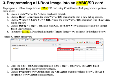

db16122
You can refer the information below and related application notes for detail
