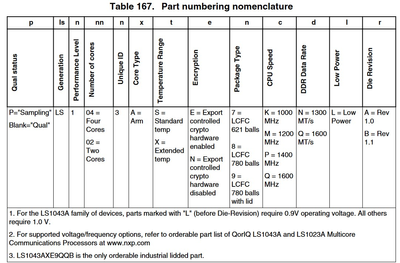

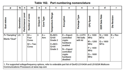

Could you tell to me difference between ls1043A1 and ls1043A2 processor ?
1,032 Views
Chavira
Hi @sergepayre!
Thank you for contacting NXP Support!
The datasheet explains the features who have each part number of LS1043.
