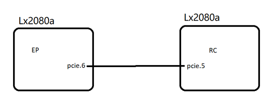

I have two lX2080A custom boards, one of which is rc and the other is EP.
Currently, ep devices can be discovered at the RC side.
But the PCITest failed: can't open PCI Endpoint Test device: No such file or directory.
Ep Device log and  RC Device log is in the attachment.

Pcie Connection
EP:
root@localhost:~# zcat /proc/config.gz |grep -i CONFIG_PCI_EPF
CONFIG_PCI_EPF_TEST=y
root@localhost:~# zcat /proc/config.gz |grep -i pci_layer
CONFIG_PCI_LAYERSCAPE=y
CONFIG_PCI_LAYERSCAPE_EP=y
 then type the following commands
# cd /sys/kernel/config/pci_ep/
#mkdir functions/pci_epf_test/func6
#echo 0x1957 > functions/pci_epf_test/func6/vendorid
#echo 0x8d82 > functions/pci_epf_test/func6/deviceid
#echo 2 > functions/pci_epf_test/func6/msi_interrupts
#echo 8 > functions/pci_epf_test/func6/msix_interrupts
#ln -s functions/pci_epf_test/func6 controllers/3900000.pcie_ep
#echo 1 > controllers/3900000.pcie_ep/start
then reboot RC to Linux:
root@TinyLinux:~# zcat /proc/config.gz |grep -i pci_endpo
# CONFIG_PCI_ENDPOINT is not set
CONFIG_PCI_ENDPOINT_TEST=y
root@TinyLinux:~# zcat /proc/config.gz |grep -i pci_layer
root@TinyLinux:~#
root@TinyLinux:~# ls /dev/p
port ptmx pts/ ptyp1 ptyp3 ptyp5 ptyp7 ptyp9 ptypb ptypd ptypf
pps0 ptp0 ptyp0 ptyp2 ptyp4 ptyp6 ptyp8 ptypa ptypc ptype
Can EP and RC communicate normally without this endpoint test device?
