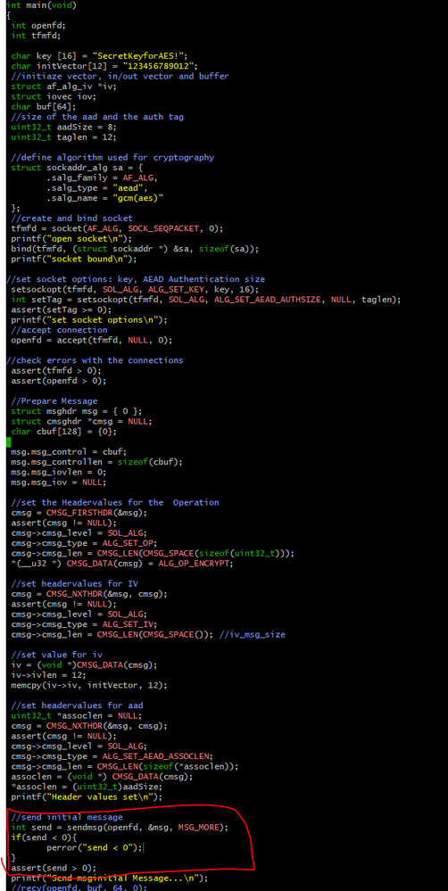

im working on the lx2160a with the sec engine. I can use the accelerators for hashing and ciphers successfully but I am struggling with use it for AEAD. I'm using the af_alg socket to communicate with the linux crypto api. At the marked position i get the error invalid Argument. I have no idead what to change, since i followed the documentation fof the kernel for the crypto api user interface.

Sorry for the delay. here is the update:
Can you check if you are setting up the sockaddr_alg structure correctly?
Following is one example.
struct sockaddr_alg sa = {
    .salg_family = AF_ALG,
    .salg_type = "aead", /* this selects the symmetric cipher */
    .salg_name = "gcm(aes)" /* this is the cipher name */
The thing is that this is a standard Linux interface. We (NXP) can only control the ciphers registered by the SEC driver.
Also, it would be good know which specific algorithm are you trying to use.

Thanks for the reply, i had an mistake in configuring the sec. I was able to fix the mistake and everything is working fine now.
1,465 Views
td71522
the length in cmsg->cmsg_len = CMSG_LEN(CMSG_SPACE());
is meant to be cmsg->cmsg_len = CMSG_LEN(CMSG_SPACE(sizeof(initVector)));
idk why its missing
