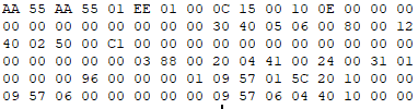

Why is the byte order of the image created with Flex-builder (bl2_qspi.pbl) different?
888 Views
nekarose

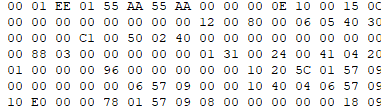

Why is the byte order of the RCW+PBI+BL2 image mounted on NOR flash different from the byte order of the bl2_qspi.pbl image built through flex-builder?
<NOR Flash>
<bl2_qspi.pbl>
I am currently trying to do flash programming using T32, but it does not work properly when the bl2_qspi.bpl file is applied due to the byte order difference as above.
870 Views
Teddy1
Look at the chapter "CCSR address map" of your Layerscape processor, for QuadSPI, there is written "Big-endian (byte swapping required)"
I use T32 to flash my QSPI Flash NOR and I do swap bl2 and fip for usage with T32 (and I use bl2/fip binaries not swapped when updating from Linux /dev/mtdX)
FLASH.ReProgram.ALL
pRINT "select RCW ( /bl2_qspi_swp.pbl) binary..."
Data.LOAD.binary arm64_target\lauterbach\bl2_qspi_swp.pbl D:40000000 /Long
pRINT "select u-boot ( /fip_swp.bin) binary..."
Data.LOAD.binary arm64_target\lauterbach\fip_swp.bin D:40100000 /Long
